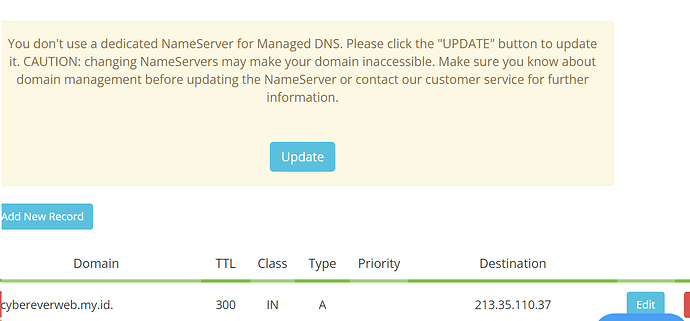

Creating ns1.domain.tld & ns1.domain.tld, not working
My registrar said my domain need these dns
Name Server: ns1.mysrsx.com
Name Server: ns1.mysrsx.net
Name Server: ns2.mysrsx.com
Name Server: ns2.mysrsx.net
In order to use the dns management system on their system
I told them about this matter and they still insisted that it should be the wrong setup at the server
If you use THEIR dns servers you are not using YOUR dns servers.
I’m sorry but this issue is not related to Hestia.
In the nameserver I need to input their nameservers, total 4 NS
Then I can use the managed/custom DNS
But, yeah, it should be their issue
I’ll try other registrar
