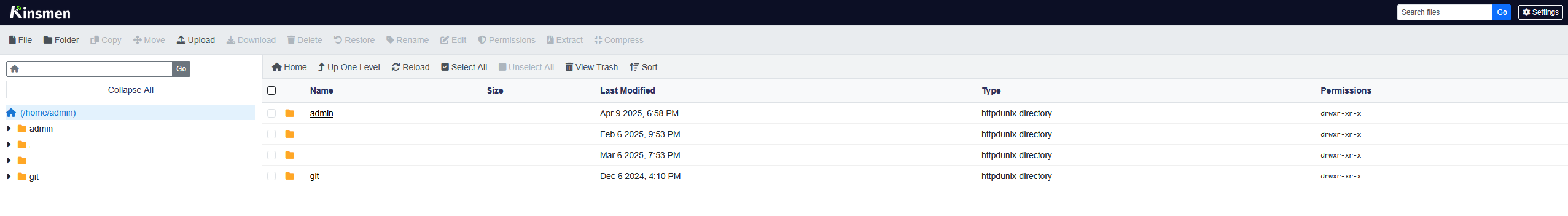

Update: Even though folders show up, files do not. Still trying I guess.
I’ve tried that method and it still had the permission problem (made use of session for directory). Files will show up but nothing happens. I’ve also tried using hestiacp file system commands and still same problem.

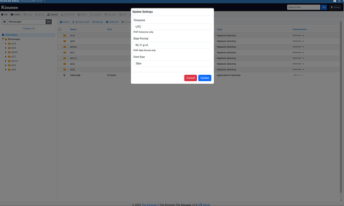

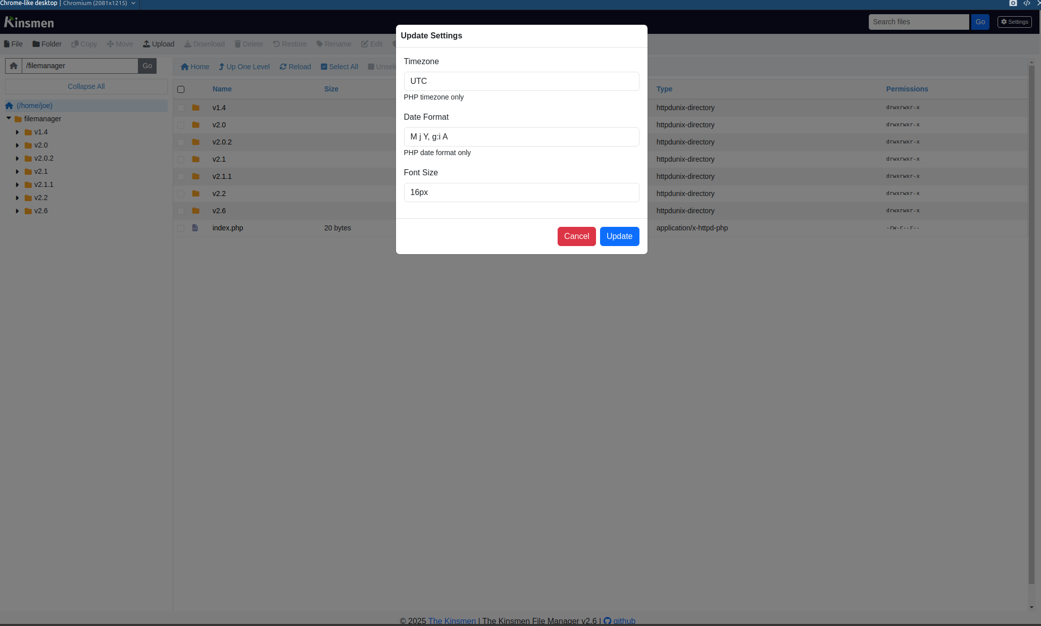

.fm-config is the file manager user configuration file which overrides the timezone,date_format,font_size in the $config array when the filemanager settings is modified. I added Settings in v2.4.
For local testing, the $username can be anything (current user) and $root_path should be writable by the logged in user.
I run a LAMP server on my ubuntu desktop and set root path: /var/www/html/public with read/write access to it and modified the ownership also (joe:joe).
