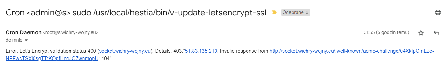

Error - Let's Ecrypt Cron
Hi.
Let’s Encrypt certificate renewal issue is back :frowning:
How can I fix this?

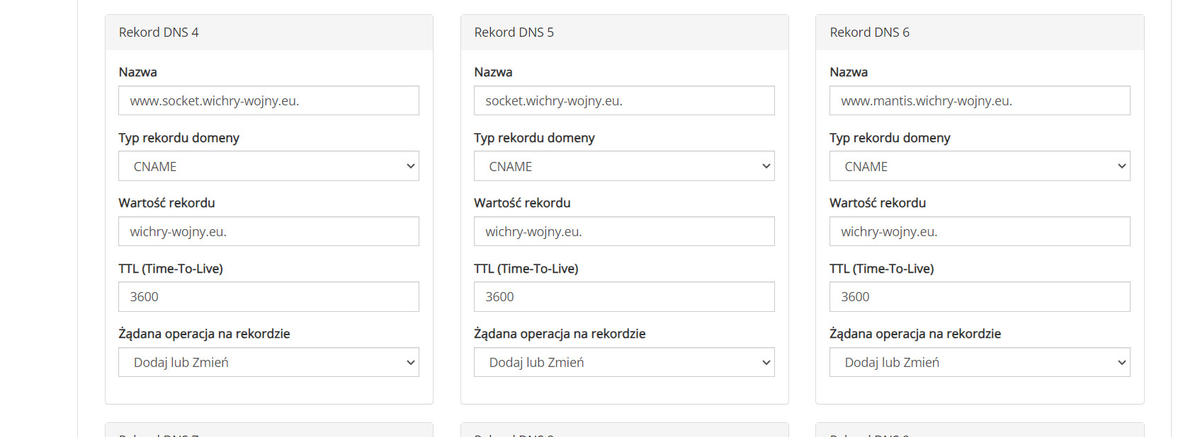

Well, he didn’t tell me much. I see that I have DNS to my server for the main domain - and for the child zone I do not have it set. But what should I do next?
DNS is set for subdomains.
OK, child zone added.

http://socket.wichry-wojny.eu/.well-known/acme-challenge/04XklpCmEze-afeafwefa
Returns a 404 that should never be possible…
Well, only I didn’t do anything, I don’t know why it returns an error :frowning:
When I add the LE certificate for the first time, it works, and refreshing the certificate gives an error - and it was the same 3 months ago :slight_smile:
It helped to remove the socket.wichry-wojny.eu subdomain, re-create the socket.wichry-wojny.eu subdomain and re-set the LE certificate ;/ but it’s stupid ;/
