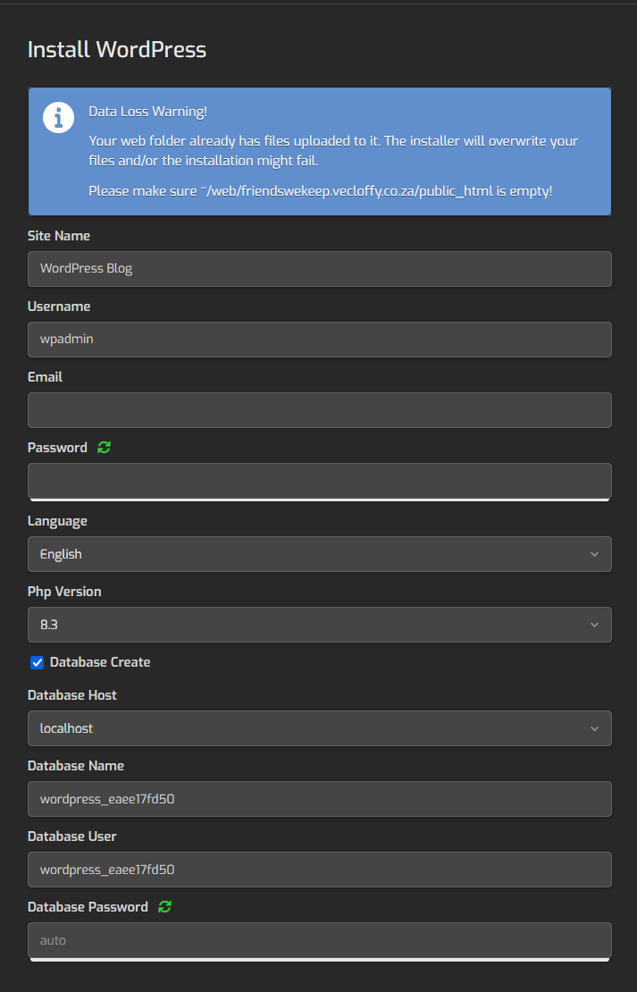

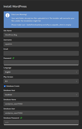

Hestia recent update does not let me specify where to install WordPress
Is this new or is this a bug, hestia seems to now only install wordpress via the quick install action to public_html and does not allow me to specify a subfolder like I was able to previously.
I don’t know the reason, but it was removed in PR #4694 and merged on Feb 27, 2025.
