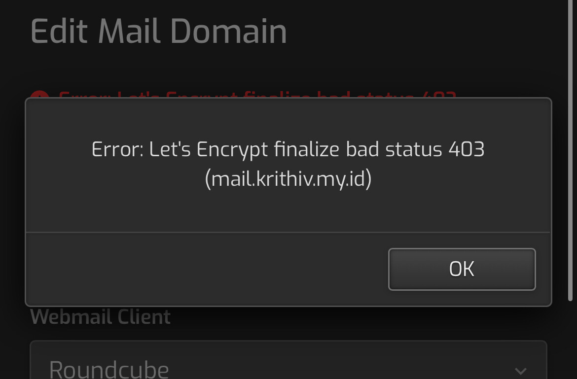

I’m totally new to HestiaCP and I got setup my server for the first time. I’m planning to use my server as only Mail Server and I facing some issues with it.
Firstly, my hostname ssl was not issued and I tried to issue manually using HestiaCP (hCP) and it throw me an error. Moving on I setup my mail domain and using Cloudflare, I setup A records for webmail (webmail.krithiv.my.id) and mail (mail.krithiv.my.id) pointing towards my server with dns only configuration but it also throw me an error. ( I know it’s not necessary I did it anyway ) I pointed my main domain (Krithiv.my.id) towards the server and added as a website and tried anyway but still it failed.

You guys can help me solve this issue… :blush:
As I mentioned I’m new to hCP and Linux I might need detailed solution :dizzy_face: :face_with_monocle:

Hi guys. I got responses from the hosting provider and they made few changes and it works!
I was able to fetch ssl for both hostname and mail domains as well!
Thanks for your interest in helping me! You guys are best! :hugs:
