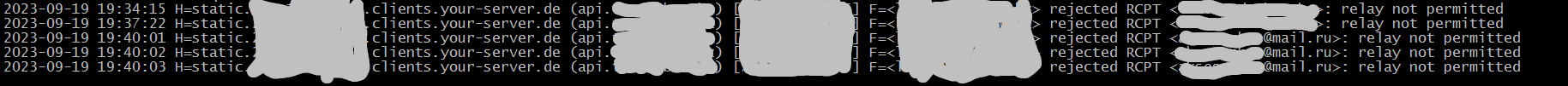

unclear error when sending via smtp
rejected RCPT [email protected]: relay not permitted
although if you send it via webmail, the letter goes out normally, I need help…
I figured out this reason, the reason was that the client that connected to the mail server did not pass authorization, switched to TLS and everything worked.
