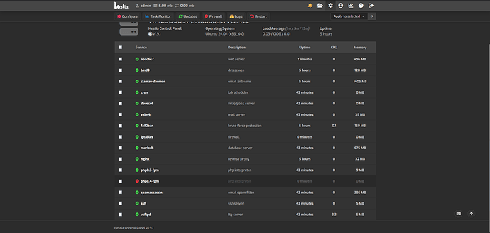

All of a sudden all my sites were throwing 500 server errors. I checked the services in the UI. Php-fpm 8.3 service was disabled. I tried to start it but it didn’t start.
Now I switched back the system PHP version to 8.3. and started the php-fpm 8.3 service using the UI. It started and the sites are back online.
Now I went inside the WordPress panel to check the system status. To my surprise, PHP 8.4 was being used. Even though I have 8.3 selected it is still using version 8.4. I can confirm that. I checked the services, PHP 8.4 fpm is utilizing the CPU not 8.3.

Here are the screenshots to explain it better
Hope this helps
