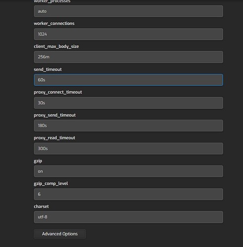

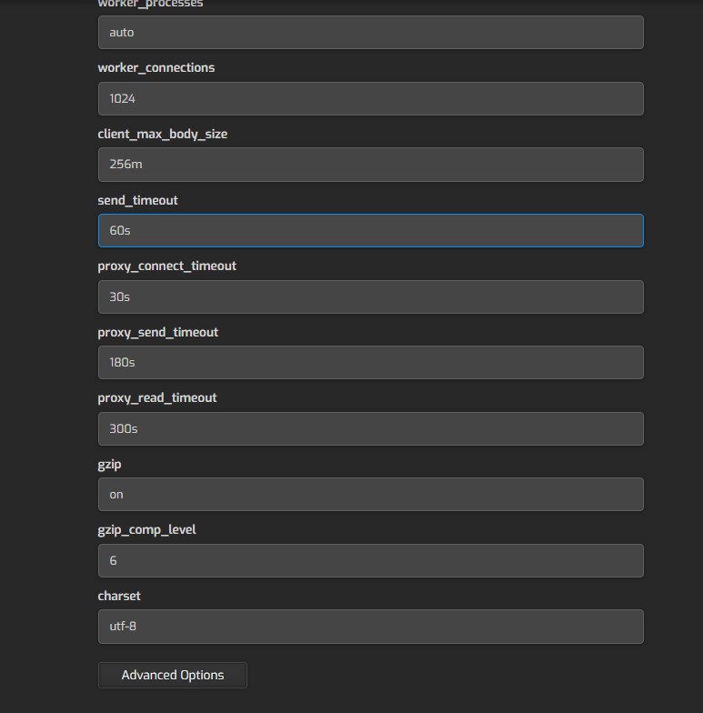

do I need to change any settings here?

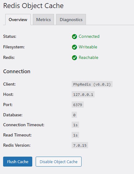

OK redis server plus PHP package what are the correct commands to install that into hestia, on debian 12.x, php 8.2
apt install redis-server php8.2-redis
If systemctl status nginx shows nothing about the error, check /var/log/nginx/error.log and /var/log/nginx/domains/YourSite.error.log
perfect, thank you, done and working…
