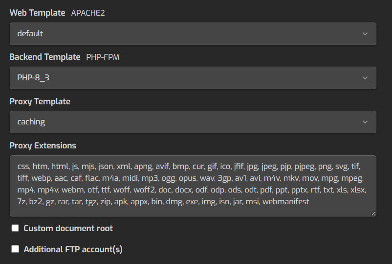

Just installed WordPress and its so slow and idk why. I have OPCache enabled, turning Nginx caching on (using the template) and still so slow.

Now I know I’m not local to the server, its in Europe and I’m in the US but seeing as everything else appears to be lightning fast, just not WP, I’m failing to understand. I also installed it with the autoinstaller HestiaCP has, and I also am using PHP 8.3. I just need help making it usable. I checked and monitored CPU and RAM usage, and it appears fine.
I don’t think I need a server upgrade, this is an optimization issue or smth. I’m using no custom templates, only what came with HestiaCP.

I installed it brand new via HestiaCP autoinstaller, instantly slow, even before I installed a theme. Theme didn’t make it any slower. Installing it again on a new subdomain is a waste of time imo.
