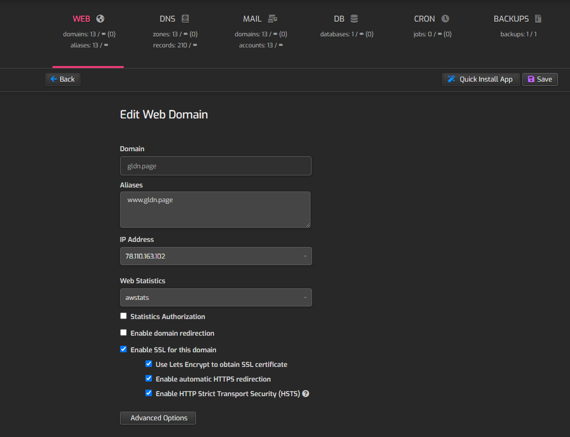

Maybe I can make it see that SSL is enabled by …
just creating some new certs with this.
Since I am using a custom template, maybe it will ignore the new cert and look at the path ??
Any thoughts?
( I haven’t saved this yet - not sure if it’s a good idea ! )
And BTW - this domain has SSL email set up already
Thanks to Eris, I think I am close to getting it sorted, just this final hurdle !!
