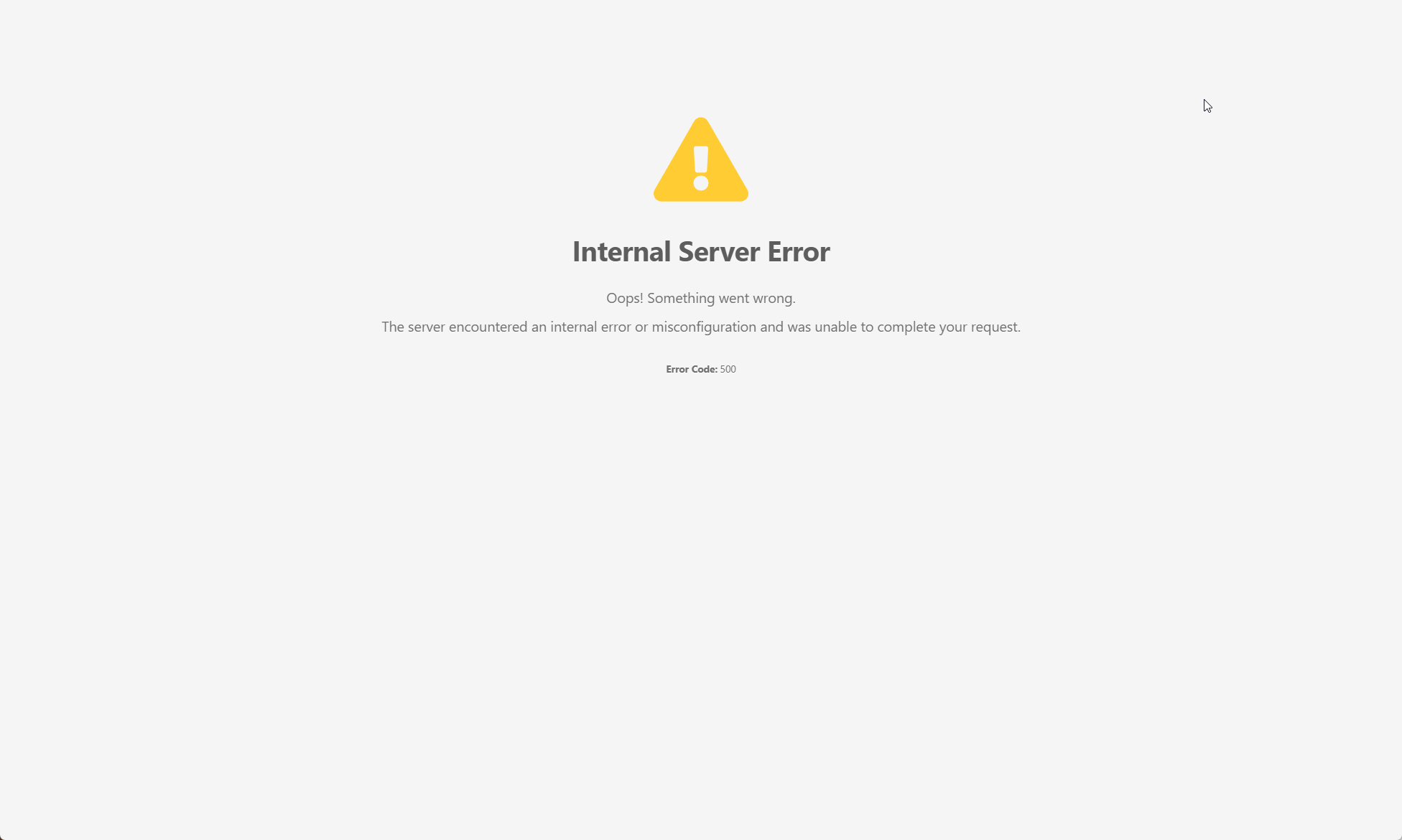

I think hestia updated at some point and I cannot log into the admin anymore I just get a 500 error.
root@web:/var/log/hestia# tail -f nginx-error.log
2025/03/25 23:26:51 [error] 985#0: OCSP response not successful (6: unauthorized) while requesting certificate status, responder: r3.o.lencr.org, peer: 95.100.133.139:80, certificate: "/usr/local/hestia/ssl/certificate.crt"
2025/03/25 23:26:54 [crit] 985#0: *7 connect() to unix:/var/run/hestia-php.sock failed (2: No such file or directory) while connecting to upstream, client: 45.13.7.62, server: _, request: "GET /login/ HTTP/1.1", upstream: "fastcgi://unix:/var/run/hestia-php.sock:", host: "web.warol.net:8083"
2025/03/25 23:28:22 [crit] 985#0: *11 connect() to unix:/var/run/hestia-php.sock failed (2: No such file or directory) while connecting to upstream, client: 45.13.7.62, server: _, request: "GET /login/ HTTP/1.1", upstream: "fastcgi://unix:/var/run/hestia-php.sock:", host: "web.warol.net:8083"
2025/03/25 23:28:37 [crit] 985#0: *11 connect() to unix:/var/run/hestia-php.sock failed (2: No such file or directory) while connecting to upstream, client: 45.13.7.62, server: _, request: "GET /login/ HTTP/1.1", upstream: "fastcgi://unix:/var/run/hestia-php.sock:", host: "web.warol.net:8083"
Any ideas?
