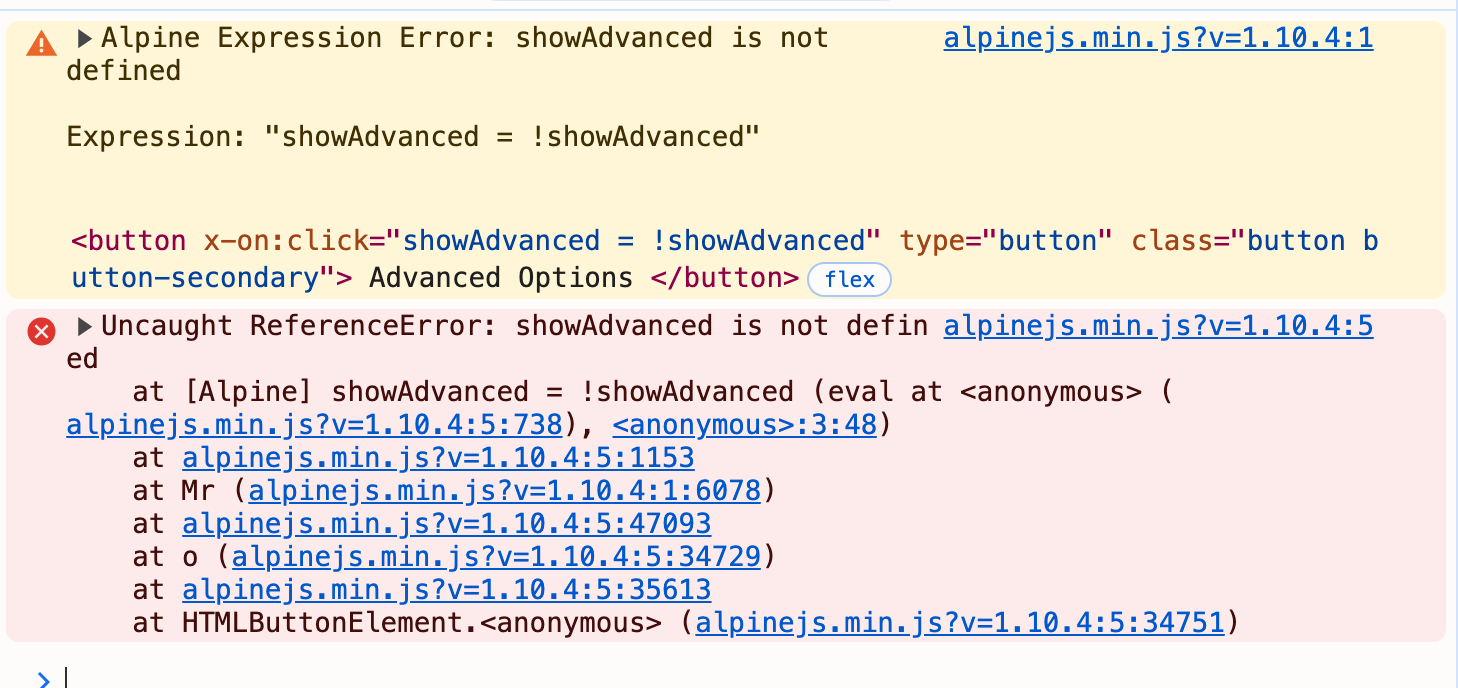

Advanced Options button does not work. Console error Alphine
the “Advanced options” button does not open the panel. this same for existing web accounts created and for new ones.
When checked, An alpine error is seen in the browser Javascript console.
I did restart the hestia service, restarted my entire virtual server node. still the error appears. What could be the root cause?

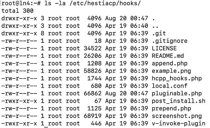

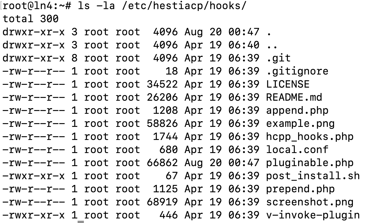

ls -la /etc/hestiacp/hooks/
You are using hestiacp-pluginable. That module is not supported by Hestia, and it looks like it isn’t supported by its creator either, so you should uninstall it.
i manually removed the plugin. it broke my php but managed to fix by commenting out the lines inserted by the pluginable plugin.
