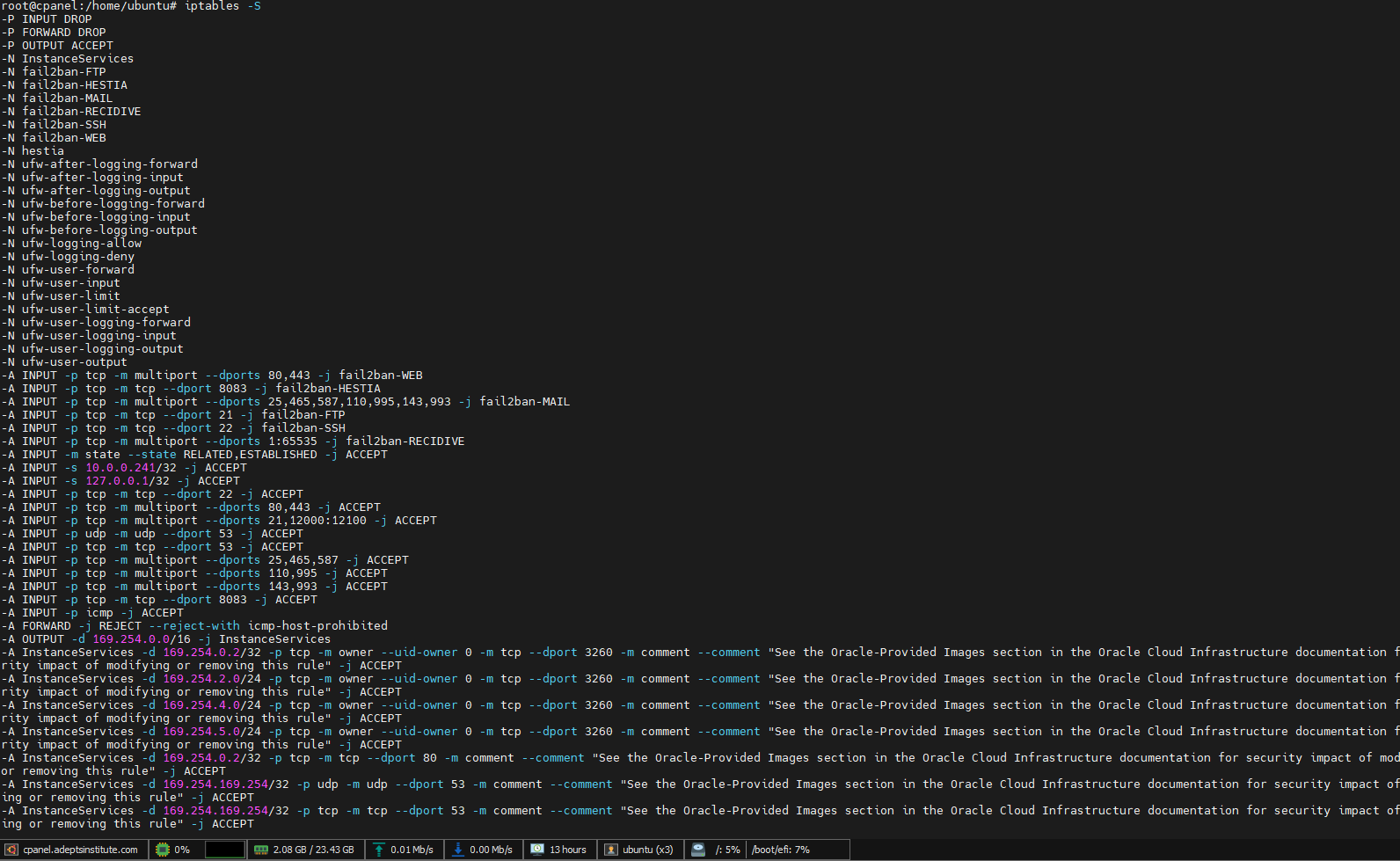

Also, could you please show the output of:
iptables -S
Ok. I have just changed the port from 8083 to 2086 thinking it might be cloudflare blocking it. Anyways this is iptables -S info:
