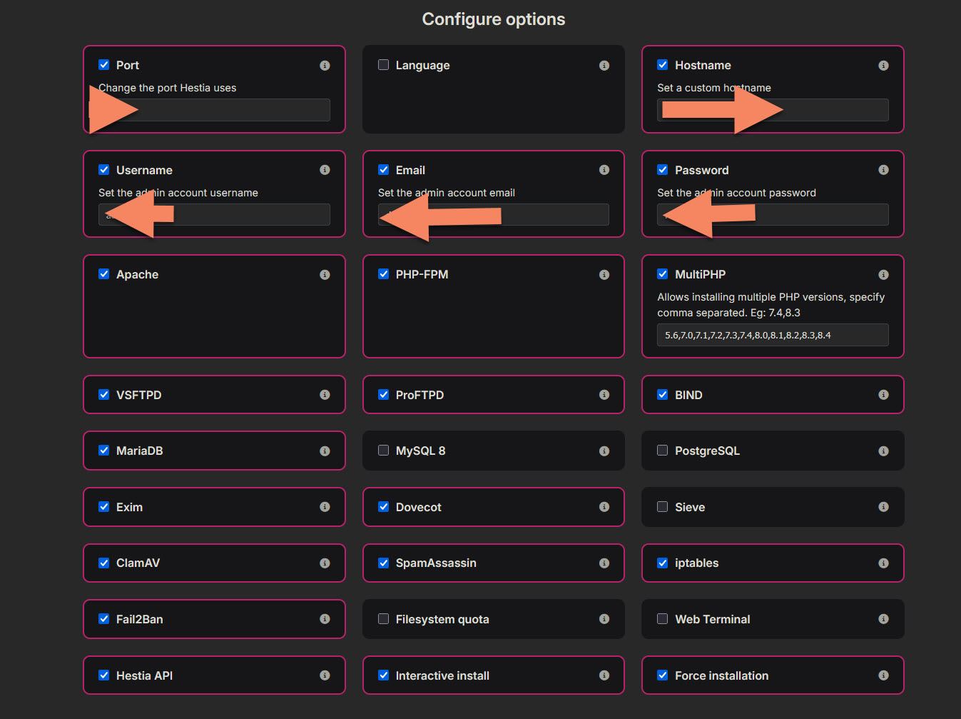

im using custom config for new installation, here is screen shorts, please help me

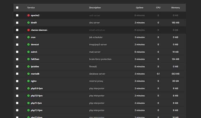

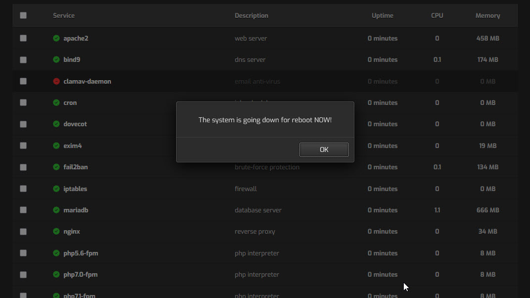

other issue check screen short i have restart the server and after come back now apache2 worked but [ clamav-daemon ] not start,
root@:~# journalctl -b -u clamav-daemon
-- No entries --
root@:~#

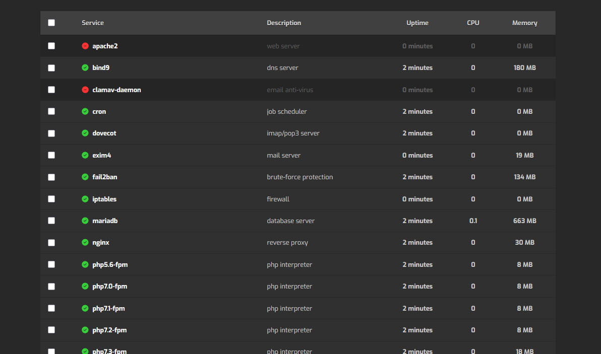

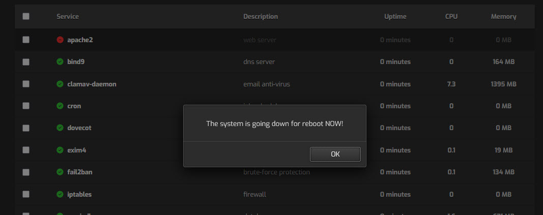

now come online after restart but apache2 stop im try 3 time to restart server , same result, apache not start automatically . need start manually
clamav-daemon
do i re.installed panal ?
No.
What do the logs say when apache doesn’t start?
im try restart from contabo panel when it come back same apache not start, where do i check logs, ?

Is there any other service listening on port 8443?
lsof -Pn +c0 -i:8080,8443 -sTCP:LISTEN
no its fresh installed not add anything yet.
nothing show. after restart same, apache not start.
Then that means apache is trying to start when the ip has not been assigned yet so it fails.
Edit the apache2 service:
systemctl edit apache2.service
and add this:
[Unit]
After=network-online.target
Wants=network-online.target
It will look like this:
### Editing /etc/systemd/system/apache2.service.d/override.conf
### Anything between here and the comment below will become the new contents of the file
[Unit]
### Lines below this comment will be discarded
Save the file.
Now check whether one of these services is available and enable the service only if it’s available:
systemctl status systemd-networkd-wait-online.service
systemctl enable systemd-networkd-wait-online.service
or
systemctl status NetworkManager-wait-online.service
systemctl enable NetworkManager-wait-online.service
Now reboot again.
finally its worked now, thank you so much for help.
