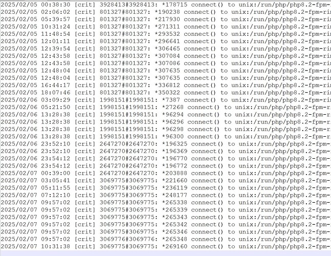

I have the number of servers which migrated to new version (Hestia Control Panel v1.9.1).
All servers have same problem and problem happens on all sites.
Error happens 10–20 times a day on every site.
Error started on 04/02/2025.
Server data:
  • Ubuntu 22.04
  • Nginx + php-fpm
Error example:
2025/02/07 10:21:29 [crit] 2227399#2227399: *514560 connect() to unix:/run/php/php8.1-fpm-xxxxxxxxxx.com.sock failed (2: No such file or directory) while connecting to upstream, client: xxx.xxx.xxx.xxx, server: xxxxxxxxxxxxxxx.com, request: "HEAD /xxxxxxxxxxxxxxxxxxxxx HTTP/2.0", upstream: "fastcgi://unix:/run/php/php8.1-fpm-xxxxxxxxxxxxxx.com.sock:", host: "xxxxxxxxxxxxxxxxx.com"
Please let me know with system settings changed so I will try to play with it and change it back in order to resolve the errors.
We have not changed anything with websites templates.
So that is strange…
When does it happens randomly?
Or all sites on the same time?

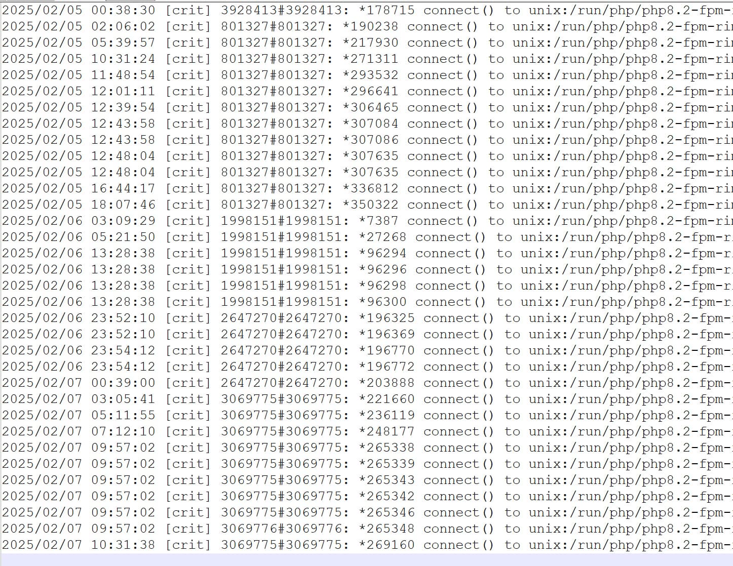

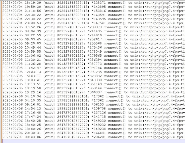

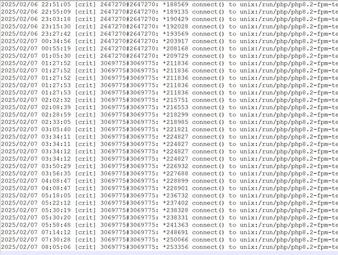

Attached screenshots of logs from different sites on same server.
Looks like it in different times.
But doing these times I see in syslog, and it’s happen every 10-30 min
