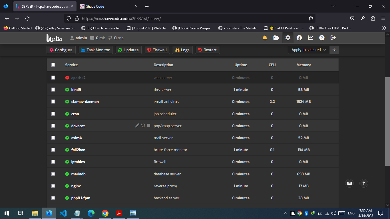

Basically, I have created a mail domain in the Mail tab, trying to use the Cloudflare SSL certificate for webmail. My website has Cloudflare protection, but to feed my curiosity I did Enable SSL for this mail domain and choose Let’s encrypt to be created.
Now the entire website is down and the website shows me an Invalid SSL certificate page.

Systemctl status apache2
apache2.service - The Apache HTTP Server
     Loaded: loaded (/lib/systemd/system/apache2.service; enabled; vendor preset: enabled)
     Active: failed (Result: exit-code) since Fri 2023-04-14 08:28:02 EET; 36s ago
       Docs: https://httpd.apache.org/docs/2.4/
    Process: 8492 ExecStart=/usr/sbin/apachectl start (code=exited, status=1/FAILURE)
        CPU: 14ms
Apr 14 08:28:02 hcp.shavecode.codes systemd[1]: Starting The Apache HTTP Server...
Apr 14 08:28:02 hcp.shavecode.codes apachectl[8494]: AH00558: apache2: Could not reliably determine the server's fully qualified domain name, using hcp.shavecode.codes>
Apr 14 08:28:02 hcp.shavecode.codes apachectl[8494]: (98)Address already in use: AH00072: make_sock: could not bind to address 10.0.0.198:8443
Apr 14 08:28:02 hcp.shavecode.codes apachectl[8494]: no listening sockets available, shutting down
Apr 14 08:28:02 hcp.shavecode.codes apachectl[8494]: AH00015: Unable to open logs
Apr 14 08:28:02 hcp.shavecode.codes systemd[1]: apache2.service: Control process exited, code=exited, status=1/FAILURE
Apr 14 08:28:02 hcp.shavecode.codes systemd[1]: apache2.service: Failed with result 'exit-code'.
Apr 14 08:28:02 hcp.shavecode.codes systemd[1]: Failed to start The Apache HTTP Server.

Looks like apache couldn’t bind to 10.0.0.198 address
you’ve something already running on port 8443, you’ll need to find out what it is and stop it.

Ok, since this is a good chance to learn, here is my try to find out what process use the specific port.
First I ran this command
netstat -ano -p tcp
and here is the outcome
tcp        0      0 10.0.0.198:8443         0.0.0.0:*               LISTEN      15621/nginx: master  off (0.00/0/0)
So looks like the Nginx master server is taking over the port.
Next, I decided to kill the process just to see the result, so I ran this command and specify the PID
kill 15621
But still, the issue is not being resolved. I know I killed the Nginx master server. I should note that I am using a Cloudflare certificate, I kind having a sense that the problem comes from this part, but couldn’t find out where to start.
