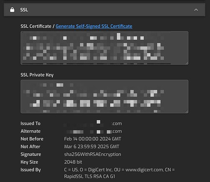

I have a certificate installed, or at least, I thought I did. When finding and running the Raycast Plugin, after setting the details. I’m getting this error, but I don’t understand why it’s giving me this error.
ERROR
Something went wrong
request to https://MY.SERVER.com:8083/api/ failed, reason: unable to verify the first certificate
I have a digicert certificate installed for the my.server.com:8083, My assumption would be that this would be my certificate for all server functions, API or otherwise. I don’t have any issues with the Web GUI, Wordpress Plugin, or a custom API for provisioning.
I can confirm that the IP is whitelisted, and the API key is correct

If Digicert uses an Intermediate CA… did you add it to your certificate?
Thanks for the reply Sahsanu, Good to see you again.
I was under the impression that digicerts root and intermediate certs were in everyone’s systems already, same with cloudflare and let’s encrypts chains of trust.
should I be looking on my computer or the server?
Root certificates yes, intermediate ones no.
If you share the domain name I could check it. You can send me a private message if you don’t want to share it publicly.
Anyway, you can check if you are sending the intermediate cert with this command (replace hestia.example.net with your actual domain):
openssl s_client -connect hestia.example.net:8083 -servername hestia.example.net 2>/dev/null </dev/null | sed -n '/Certificate chain/,/---/{//!p}'
