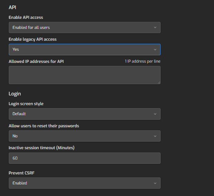

Hello, im getting error code 10 when calling my panel api, thats my code: “hestiaCP - Pastebin.com
wich option should i check to fix that? i have api allowed
Check api options is legacy api enabeld?
all on ig
You should add the ip of the client from where you are trying to connect to use the api to the Allowed IP field. If it is the same machine, add 127.0.0.1 and your public ip to the list.
hello i did what you told me and didnt work
worked, it wasnt mi public ip, was vps ip
