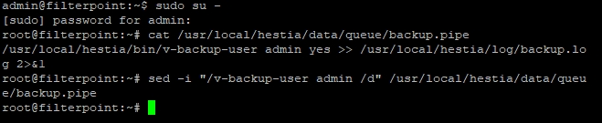

Thank you, now I have made some progress in this matter. I have executed all the commands (attached photo) and now it allowed me to create a backup again. But for 30 minutes nothing has been created yet. I suspect that I have written something incorrectly? Can you please check me on the screen?
Please advise… I entered both commands as you indicated, I am attaching a photo. Tell me, did I do everything correctly or is there something wrong? Maybe the problem is somewhere else?
No, you did it fine, the problem is the backup, it’s stuck or failing for some reason.

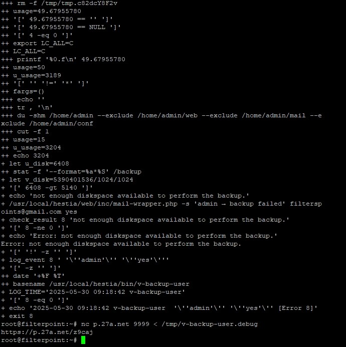

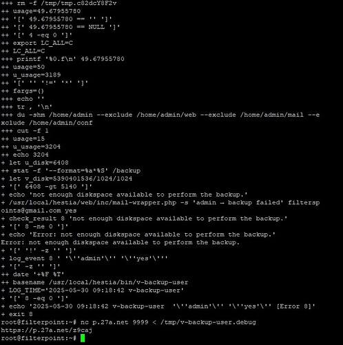

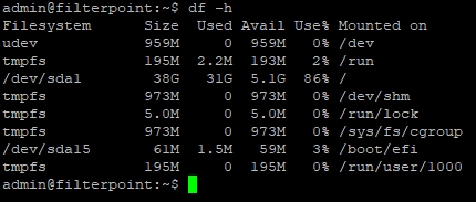

I entered all the commands you specified. On one of the commands I saw an error - “Error: not enough diskspace available to perform the backup.” I understand - this is the problem? I am attaching a screenshot.
Yes, seems so, Hestia checks that you have at least twice the space of what the user’s backup will occupy, but it should delete the backup.pipe line when this happens.

I ran these commands yesterday (screenshot). But no changes, cron doesn’t work (if it was supposed to work of course).
The last message echo 'not enough diskspace available to perform the backup.' is pretty strange. Which version of Hestia do you have installed?

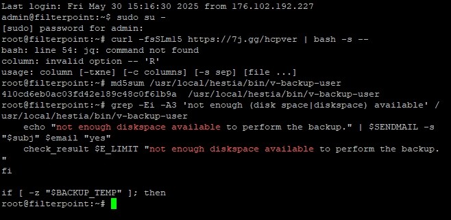

Also, please show the output of these commands:
md5sum /usr/local/hestia/bin/v-backup-user
grep -Ei -A3 'not enough (disk space|diskspace) available' /usr/local/hestia/bin/v-backup-user

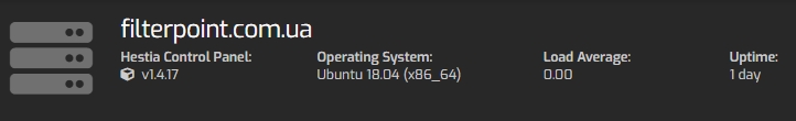

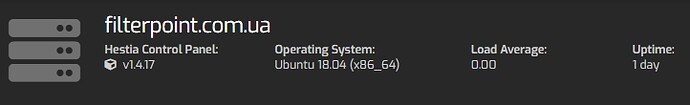

I attach 2 screenshots: 1 - version, 2 - all executed commands
You are using version 1.4.17, released on September 30, 2021, almost four years ago. When the backup fails, this version does not remove the scheduled backup from backup.pipe. The only thing I can say is whether you want to avoid this error and back up your user, then, try removing some files to free up space so the backup can proceed with the available disk space on your server.
