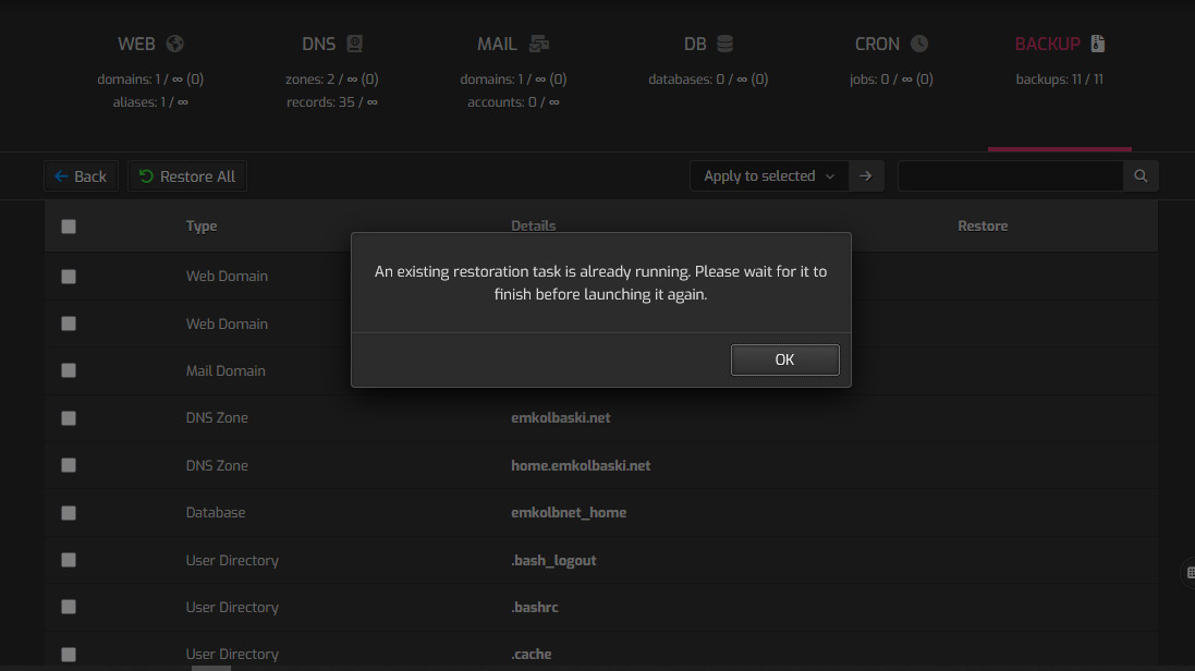

BACKUP Problem after update latest version
Guys please help. stay 120 minutes and no finish backup Web Domain.
No 4 hour no stop, try v-update-sys-queue backup NO STOP
ps -ef | grep -E '[v]-restore|[v]-backup'
cat /usr/local/hestia/data/queue/backup.pipe
disable: command not found
root@server:~# v-update-sys-queue backup
root@server:~# sudo /usr/local/hestia/bin/v-update-sys-queue restart
root@server:~# sudo /usr/local/hestia/bin/v-update-sys-queue backup
root@server:~# ps -ef | grep -E '[v]-restore|[v]-backup'
root@server:~# cat /usr/local/hestia/data/queue/backup.pipe
/usr/local/hestia/bin/v-restore-user emkolbnet emkolbnet.2026-06-11_05-51-14.tar 'emkolbaski.net' 'no' 'no' 'no' 'no' 'no'  yes >> /usr/local/hestia/log/restore.log 2>&1

Execute this command and try the backup again:
:> /usr/local/hestia/data/queue/backup.pipe
root@server:~# :> /usr/local/hestia/data/queue/backup.pipe
root@server:~# root@server:~# :> /usr/local/hestia/data/queue/backup.pipe
root@server:~#
Ok, now try to run the backup
work th..you
