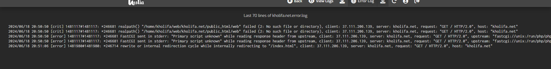

Please post a detailed error log.

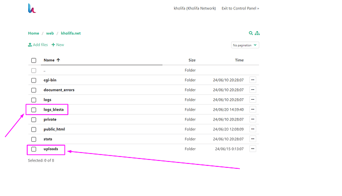

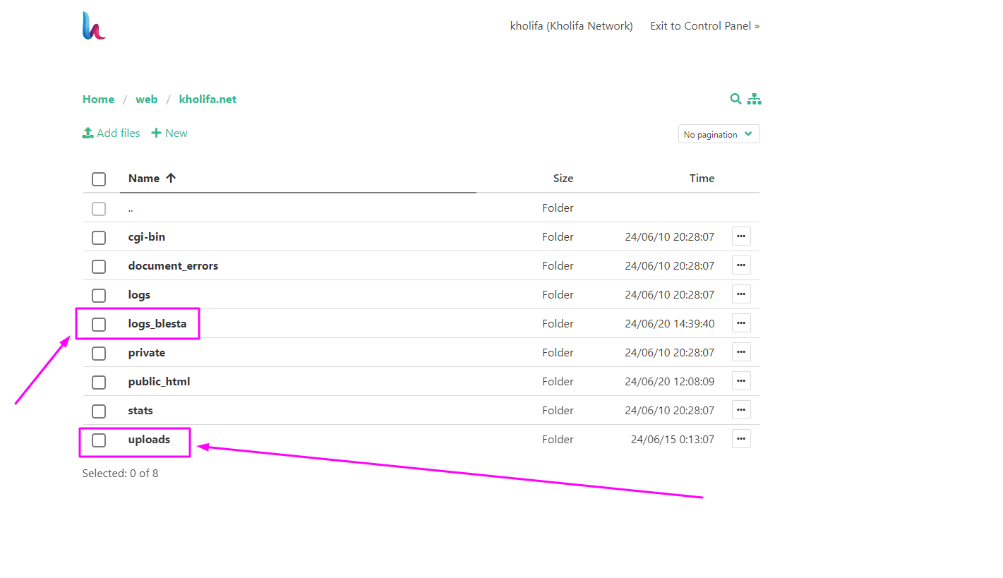

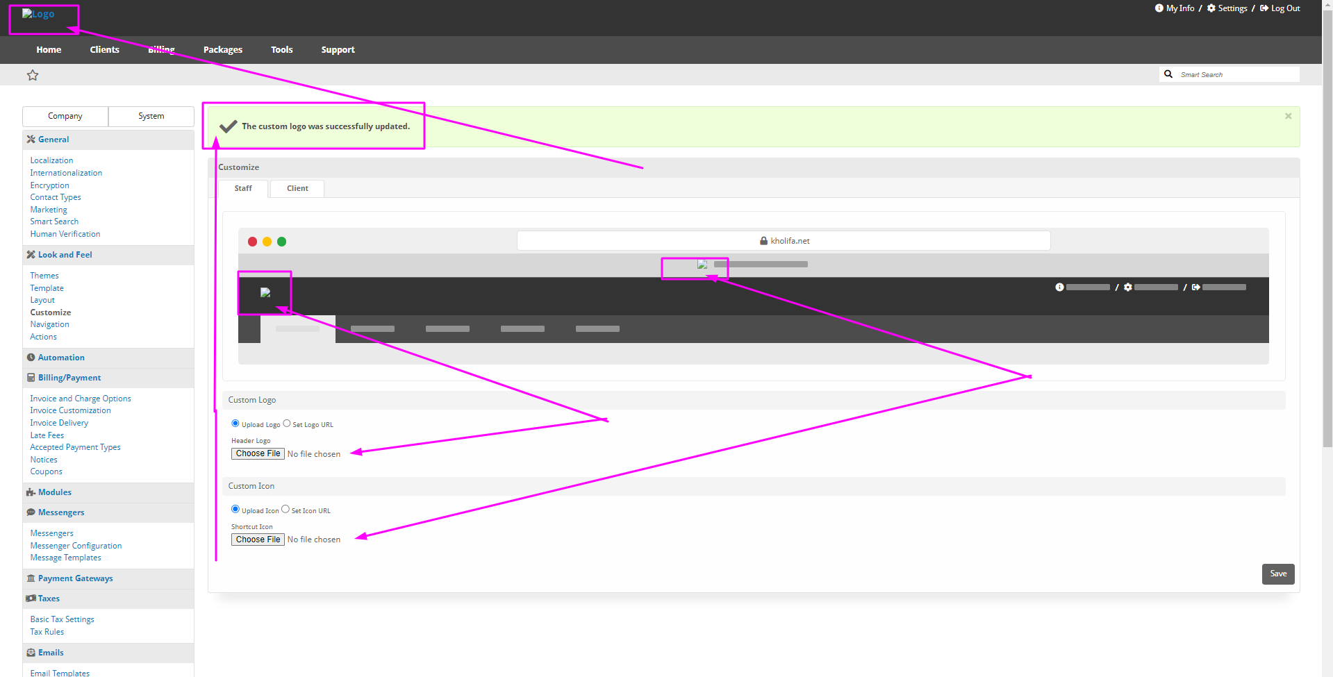

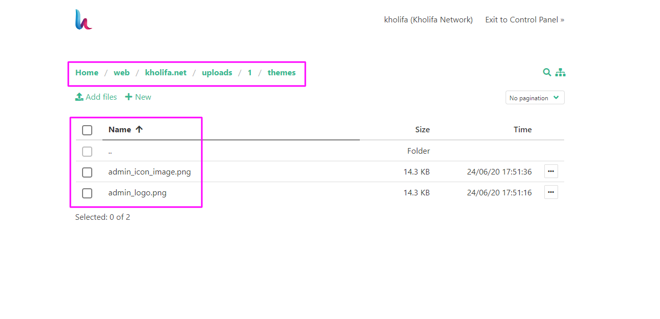

When Upload Logo, nothing Showing on Website…
But File upload to - web/user/domain/uploads/ Folder / Sub-Folder.
This is error log, but i dont found any solution from this error.
Bleasta need uploads & logs_blesta Folder with Sub-Folders – outside the root web directory (public_html)
so i need nginx Template for this… :frowning: :frowning: :frowning:

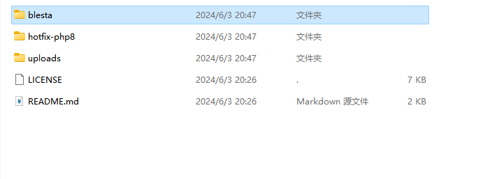

I think you got it wrong. All website files are inside public_html directory. Please upload your files inside public_html directory, uploads all files inside. public_html is the root directory of all website domains.
Please extract all the files in the blesta-5.10.0.zip compressed package into the public_html directory. This is the only way it can work. If it is outside the public_html directory, you need to modify all the configurations, which is too much work and does not conform to the working method of hestia!

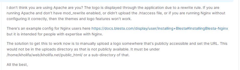

I’ve Already Contact Blesta -
They solved some errors, and told me i need to Configure nginx properly -

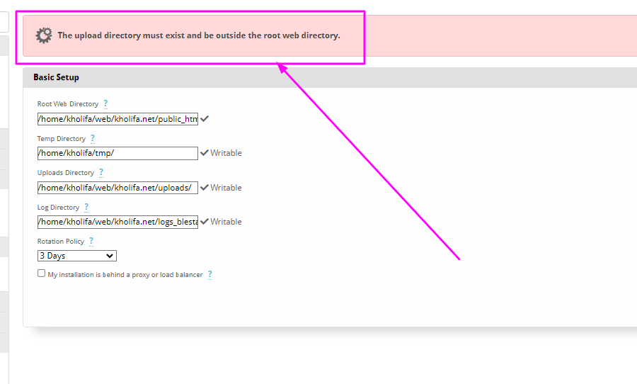

Now when i’ve try to Set Uploads Directory to /home/kholifa/web/kholifa.net/public_html/uploads - then got this error messages –

The complete operation should be to extract
to the public_html folder.
Then specify the blesta folder as the main web access directory. Please refer to the advanced options in the domain

I’ve try as per your Image, and Installed,
but when try to Set – Uploads Directory - /home/kholifa/web/kholifa.net/public_html/uploads then got Error, and Uploads Directory path are Reset with Error Message - The upload directory must exist and be outside the root web directory. :frowning: :frowning:
