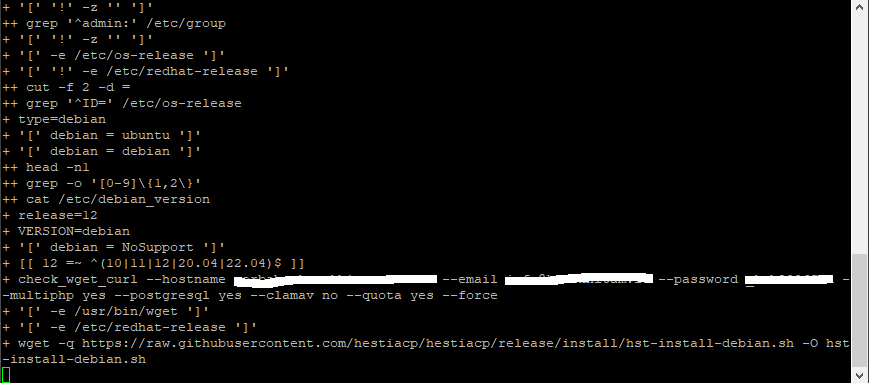

but, another problem, when i try to run the script (bash hst-install.sh) nothing happen…stuck no respon

here is the output, stuck in this state
That is because the ipv6 issue.
Try to tell your system to use ipv4 to resolve dns by default so edit file /etc/gai.conf and uncomment this line:
#precedence ::ffff:0:0/96 100
So it will look like this:
Save the file and try to wget again the hst file and see if it uses by default ipv4:
wget https://raw.githubusercontent.com/hestiacp/hestiacp/release/install/hst-install.sh
If it downloads the install script,then you can use bash hst-install.sh (without -x option)
thanks, its worked and now its installing. i see the problem about ipv6 support
