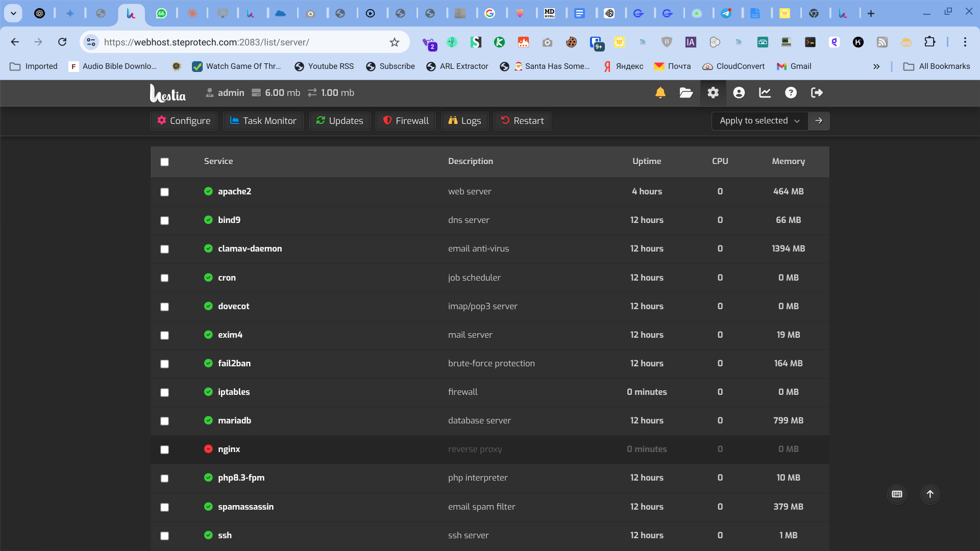

  1. during the update and upgrade, I got a prompt to either modify the nginx, without considering the consequnces, I chose to reinstall the nginx, and I guess that broke the application. I then noticed that all the domains for all the users show (too much redirects).
I’m still able to access the panel but none of the sites works. I then noticed that the nginx on the webpanel is off. I tried some troubleshooting by reinstalling and restarting the nginx and I keep getting the error that nginx cannot restart.
here is a screeshot
I have researched on how I can reinstalling just the nginx and have it running, so I can rebuild the domain, but it isn’t working.
