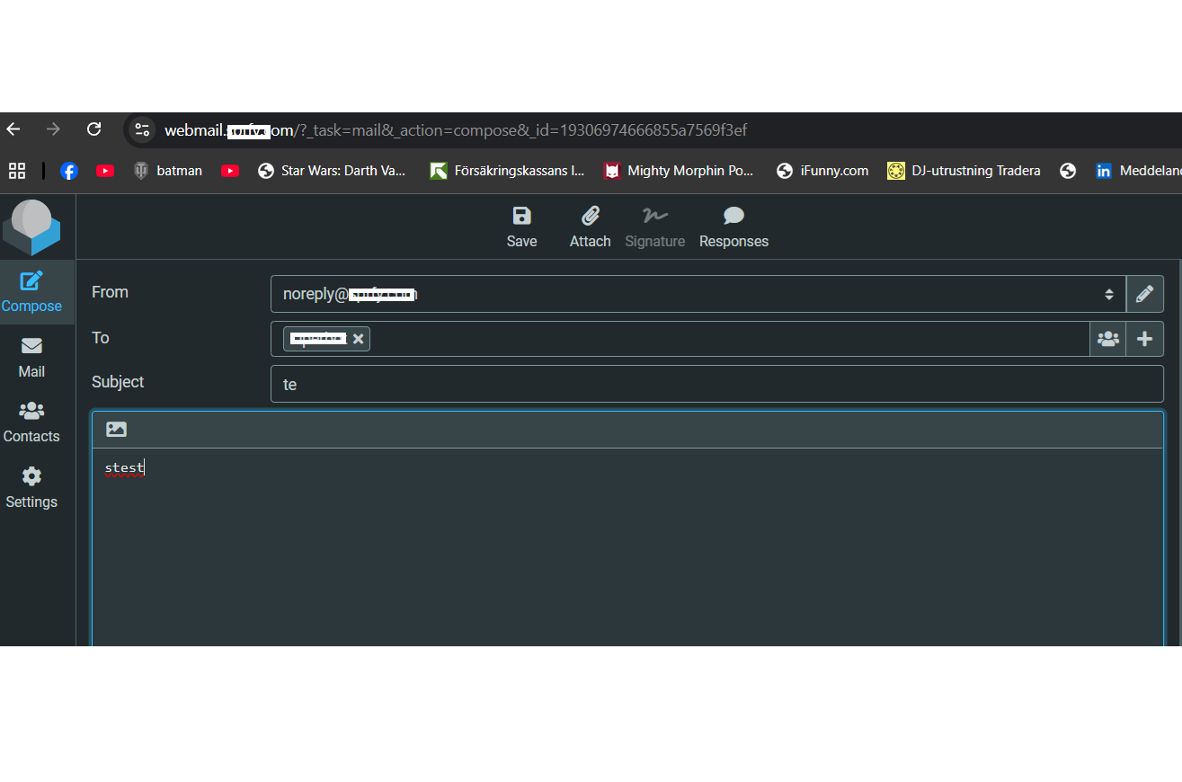

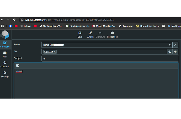

I tried to send another email and got this
iagnostic-Code: smtp; 550-5.7.26 Your email has been blocked because the sender is unauthenticated.
550-5.7.26 Gmail requires all senders to authenticate with either SPF or DKIM.
550-5.7.26
550-5.7.26 Authentication results:
550-5.7.26 DKIM = did not pass
550-5.7.26 SPF [xxxfy.com] with ip: [164.68.121.42] = did not pass
550-5.7.26
550-5.7.26 For instructions on setting up authentication, go to
550 5.7.26 Email sender guidelines - Google Workspace Admin Help a640c23a62f3a-adec897be7asi495514166b.568 - gsmtp
Subject test
From [email protected]
To xxot
Date Today 20:19
And update the DNS with SPF1 and DKIM and tried again, i got the email to my inbox. I got it to the spam folder, is that something that will got away automatically ?
2025-06-15 21:27:24 1uQt0m-000oRG-2S <= [email protected] H=localhost (webmail.sxxxx.com) [127.0.0.1] P=esmtpa A=dovecot_login:[email protected] S=523 [email protected]
2025-06-15 21:27:24 1uQt0m-000oRG-2S H=gmail-smtp-in.l.google.com [74.125.143.26] TLS error on connection (recv): The TLS connection was non-properly terminated.
2025-06-15 21:27:24 1uQt0m-000oRG-2S => [email protected] R=dnslookup T=remote_smtp H=gmail-smtp-in.l.google.com [74.125.143.26] X=TLS1.3:ECDHE_X25519__ECDSA_SECP256R1_SHA256__AES_256_GCM:256 CV=yes K C=“250 2.0.0 OK 4fb4d7f45d1cf-608b49d0107si5387569a12.360 - gsmtp”
2025-06-15 21:27:24 1uQt0m-000oRG-2S Completed
root@cloud:~#
