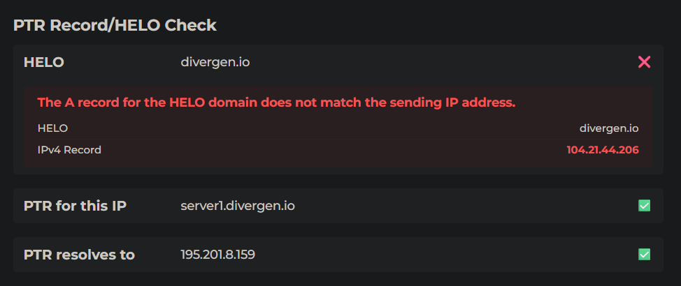

Changing EHLO for HestiaCP Email
Hey all! I changed the EHLO a long while ago but turns out recently Spamhaus put us on a blocklist because a couple things didn’t match so I’m trying to fix it. I’ve been changing the system host name and everything, turning off the cloudflare on the specific domain to ensure it resolves to the server’s IP (PTR record) and things of that nature, and the last thing is the EHLO and I’ve made multiple manual changes as well to no avail, as well as security improvements. Your help would be greatly appreciated.
