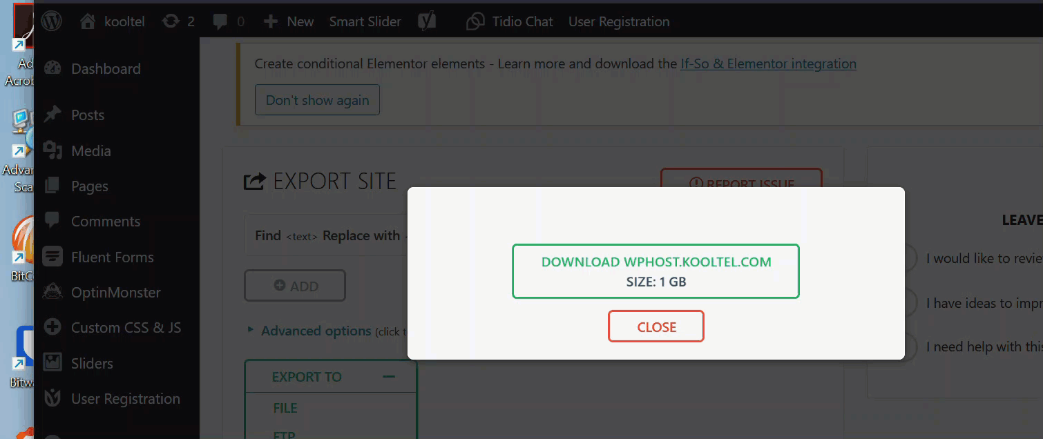

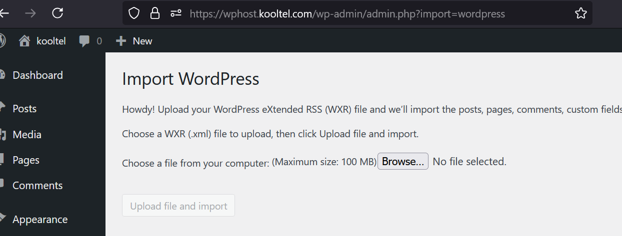

i know this topic has been covered, but they have been closed and there is never a clear resolution. I realize that i need to google this, before it gets suggested, and i have spent hours on this and i am really stuck. I am trying to transfer a wordpress website from one hestia install to another. Thats it.
  1. Word press has a max file size upload of 100mb…
  2. Hestia has a 2M file upload limit, according to the settings in /etc/php/8.2/cli/php.ini
    ; Maximum allowed size for uploaded files.
    ; PHP: Description of core php.ini directives - Manual
    upload_max_filesize = 2M
That was fairly straightforward editing the php file in the setting of the control panel; however, no matter what i do, i cannot change the export file size in wp-all-in one
1gb
more than 1GB using all-in-one wp migration. I have installed older versions which actually have the file size, not hidden and changed it to a different value.
I have read in the forums that there are other changes that might be needed, in editing the plugin files, specifically the constants.php settings.
I could transfer it using sftp; however, i think i would have to transfer the db and files separately, which i have never done before.
Any suggestions, thanks

I believe I mentioned that I changed the php settings on the hestia control panel and it worked but no change on wp. Then I changed the settings in the wp press plug in, wp all-in-one and it affected the import but not export, in fact it never changed no matter what I tried!
