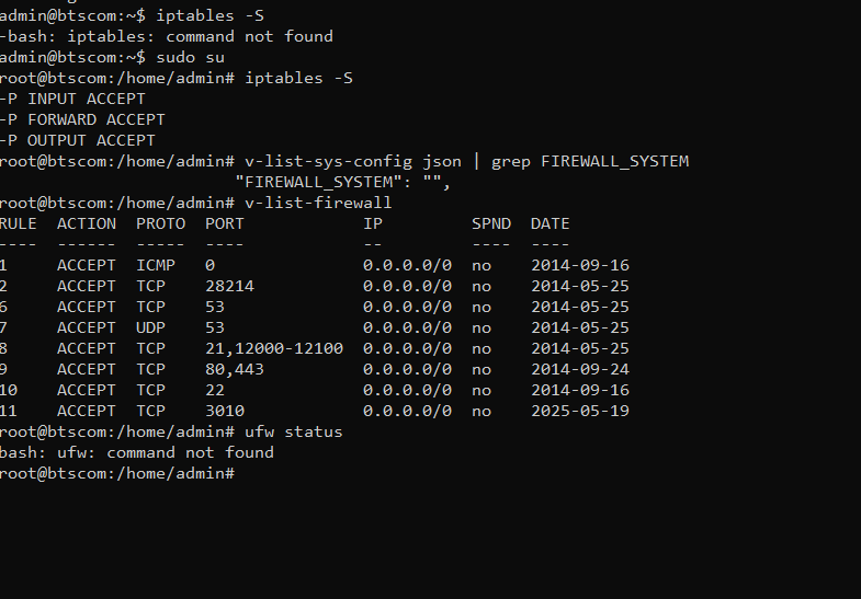

iptables -S
my firewall is off:
The command is iptables -S, with a capital S
But I would like to know why no rules are applied. When you installed Hestia what were the options you used?
v-list-sys-config json | grep FIREWALL_SYSTEM
v-list-firewall
ufw status

, but i disable firewall, i have in aws (lighsail) and port 80 and 443 is open for all.
OK, so you’ve disabled iptables and set all the policies to default accept. You have an external firewall allowing all traffic on ports 80 and 443. If that’s the case, since I don’t work with AWS, I can’t say for sure whether it’s configured properly.
Anyway, check whether CloudFront reaches Hestia server (check your website logs) but if you see nothing and iptables is accepting all traffic, seems the problem is in the conf of that Lightsail instance.

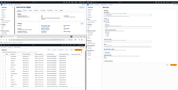

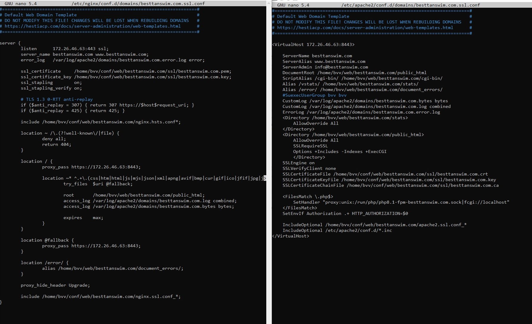

apache and nginx:
CDN:

Anyway, as I said, if it works with CloudFront disabled… I also see Nginx is listening in a private address so something must redirect the traffic from the public ip to your server’s private ip. I could say there is conf problem in Nginx or Nginx+Apache but if you enable CloudFront and you see nothing in web logs, then CloudFront is not reaching your server and it could be a connectivity issue… I don’t know.
I attach CDN only for confirm, no need help. AWS Lighsail redirect the traffic from the public ip to my server’s private ip.
