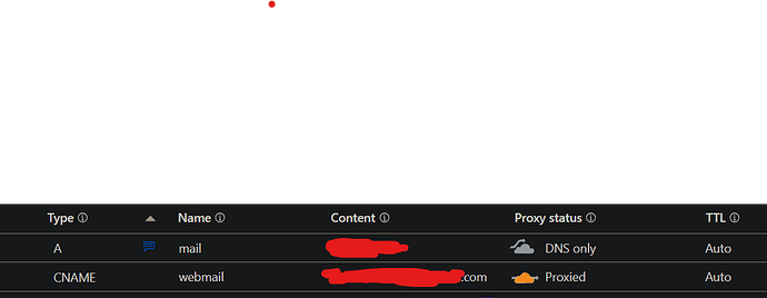

You also need to add one “A” record and add IP of your “mail.domain.com” server, for which you configured the MX record “mail” as a subdomain in Cloudflare, which is a subdomain. Just adding one MX record is not enough.
You can send all the traffic through Cloudflare, but not the mail because you need allow the reverse resolution for delivery… so mail.example.com should not have the cloud activated.
webmail.example.com can have the proxy activated.

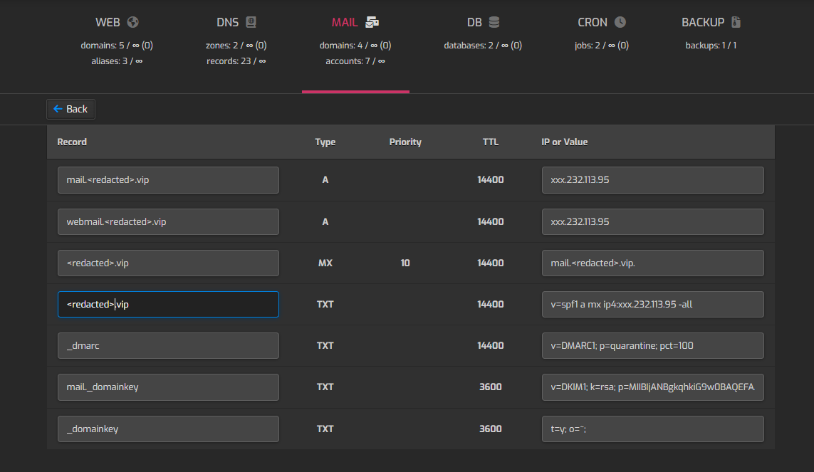

This is what I have:

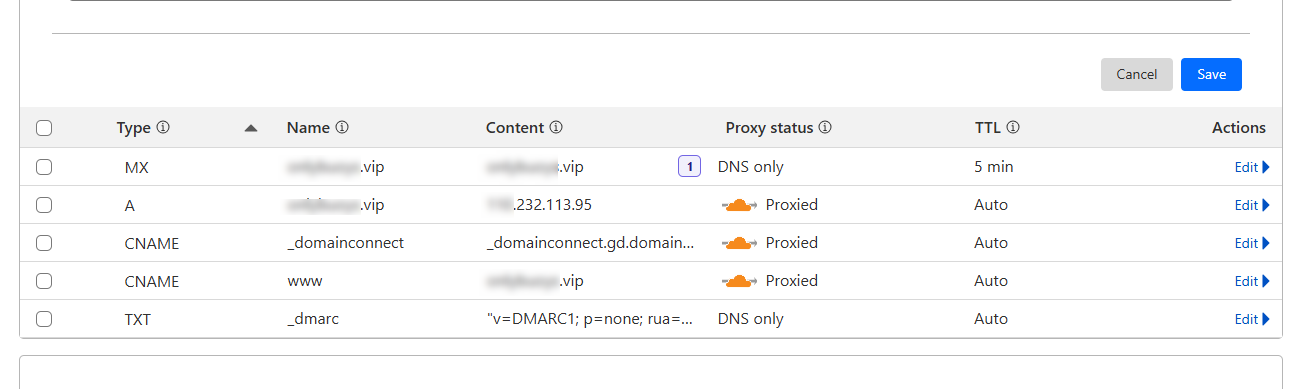

And here’s the Cloudflare config:
Adding the A record only as suggested by @Bits_And_Dragons just makes the MX record go away. Thunderbird reports “Connection refused”, either with or without.

@dug, your domain lacks of several needed DNS records.
Righ now you have the A record for mail.example.net and the TXT _dmarc.example.net (that is not using the data provided by Hestia).
And these records are not set in Cloudflare for your domain:
The SPF record for your domain example.net with the data provided by Hestia.
The DKIM (TXT record) for mail._domainkey.example.net also with the data provided by Hestia.
The MX record pointing to mail.example.net
Re-check the DNS records for your domain in Cloudlfare.

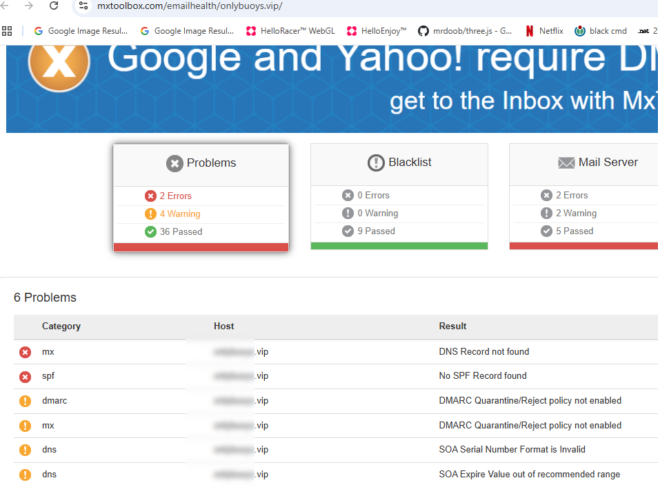

Thanks for the reply, I added ALL those records to Cloudflare, and I get no mail server config errors in MXTOOLS now, and Thunderbird seems happy connecting on port 110 and checking mail.
Anything I send to the single account I have configured in Hestia CP for that domain just vanishes. I don’t get any delivery errors. There’s still some DNS issue preventing mail from getting past Cloudflare. :frowning:

You didn’t add the MX record for your domain, there is one mx record added to mail.example.net but you must add the MX record to example.net and point it to mail.example.net. Also, you must add the DKIM record (a TXT record for mail._domainkey)
Looks like you already fixed the MX record, now the DKIM record :wink:
@dug … Please… Copy all the records of the domain from hestiacp and paste in cloudflare, fastly, akamai, imperva or any you want… but copy and paste.
The unique you must do it’s not use the proxy in the subdomain mail.
But must copy all TXT records. NS record are optional because you are using an external resolver (cloud flare in your case)
That’s is all and all work fine. Trust me.
