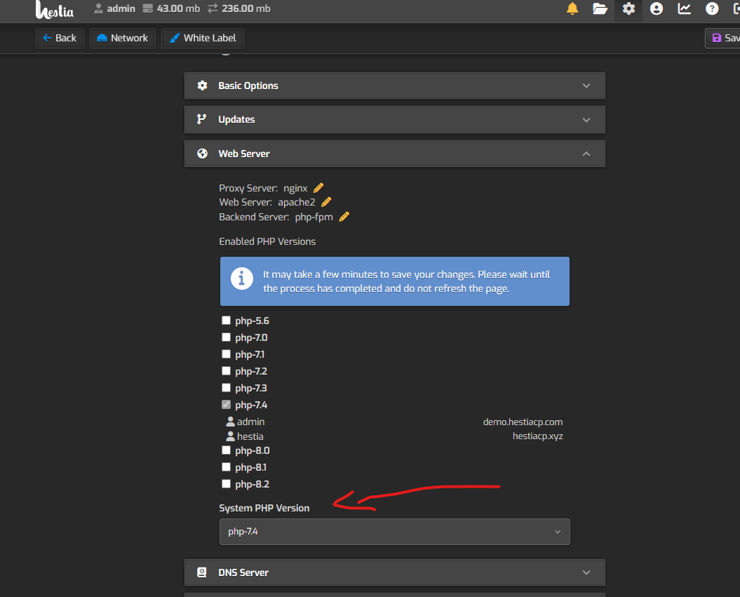

try this :
update-alternatives --set php /usr/bin/php8.1
or
update-alternatives --set php /usr/bin/php7.4
you can also do it from hestia cp settings :
