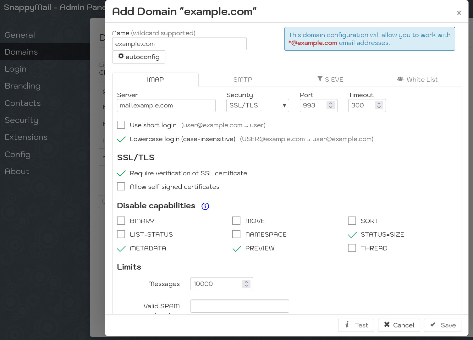

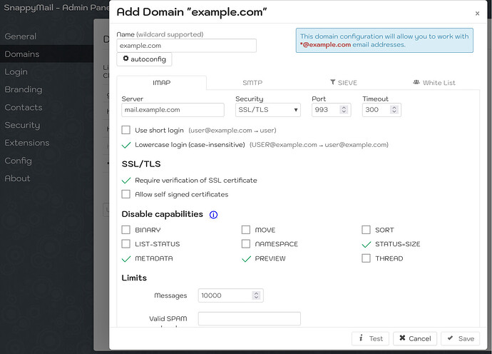

In the admin panel, go to the Domains section, click Add Domain , and fill in all the required data to connect to that email domain (IMAP and SMTP):
Once done, you can test it and save the configuration. If everything is correct, you can use [email protected] to log in to SnappyMail.
