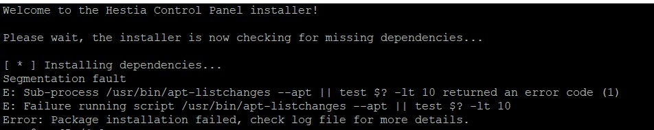

Received the following error. Where is the location of the log file?
The log is here:
/root/hst_install_backups/hst_install-HERE_THE_DATE.log
This is the content of the log file:

The log ends here?
I see no error in that log.
Anyway, before trying to install Hestia.
apt update
apt full-upgrade
I get this error again when running apt full-upgrade
Segmentation fault
E: Sub-process /usr/bin/apt-listchanges --apt || test $? -lt 10 returned an error code (1)
E: Failure running script /usr/bin/apt-listchanges --apt || test $? -lt 10
Well, something doesn’t work on your system and it isn’t because of Hestia. I would install a new and fresh OS.

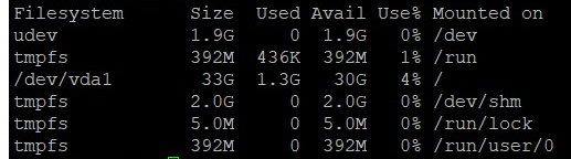

Also, I noticed that the drive is on /dev/vda1 instead of /dev/sda1
Is this an issue?
So that’s a KVM or OpenVZ VM? If you are using OpenVZ, I’ve no idea whether you need to modify something to made it to work…
It’s KVM
