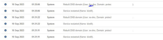

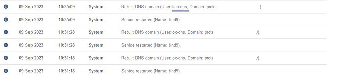

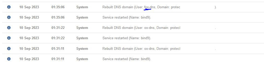

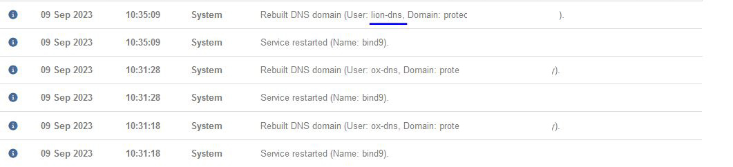

@eris Wrong DNS-USER being assigned on (both) slave
Im guessing this issue happens during the v-update-sys-que cronjob
Same domain original dns-user is ox-dns but somehow it suddenly switch to fox-dns when this happens it causes the domain to not work until i run v-sync-dns-cluster
It happens very often hopefully can find a fix…
