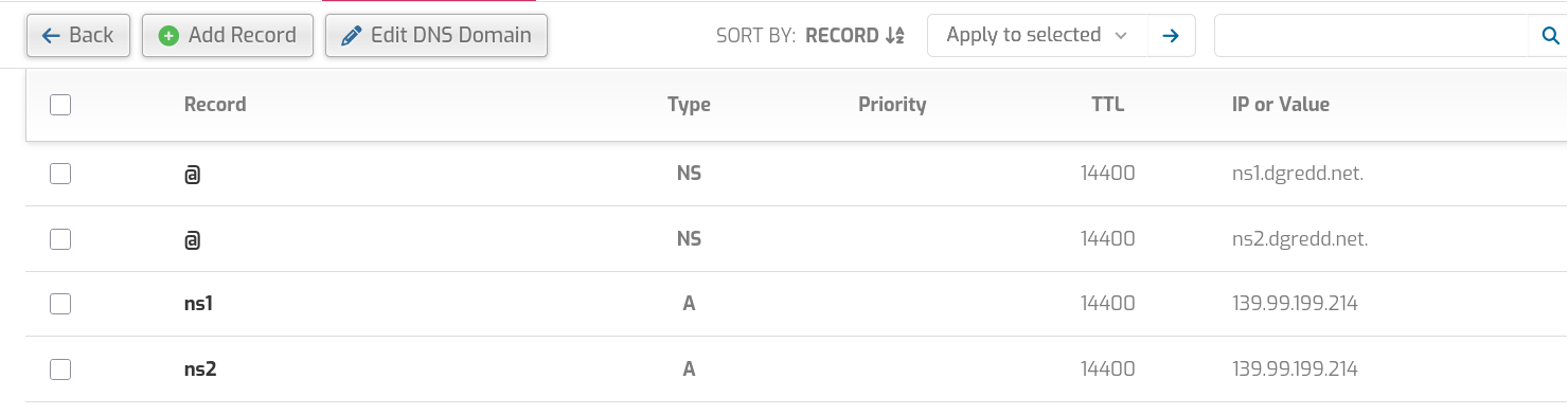

First, you must create two A records for your ns servers pointing to the public ip of your server.
Righ now, when requesting the ns servers for your domain, you get this… a NS record pointing to your public ip and that’s wrong:
❯ dig @139.99.199.214 dgredd.net ns +noall +ans
dgredd.net.             14400   IN      NS      139.99.199.214.
You should get this:
dgredd.net.             14400   IN      NS      ns1.dgredd.net.
dgredd.net.             14400   IN      NS      ns2.dgredd.net.
So, once you have added the A records for your nsX subdomains, you must create two NS records pointing to your nsX subdomains.
In Hestia the records should look like this:
