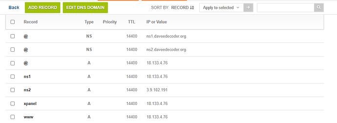

Hello,Yes, I am using two different nameservers on two different servers:
  • ns1 → 18.133.4.76
  • ns2 → 3.9.102.191
Both servers have bind9 (named) installed and running.When I stop and start the instance for ns1, I am able to access it again via my domain, but after a few minutes the issue returns and DNS checker shows “Can’t reach nameserver.”
I have attached a screenshot of my DNS records for reference.
