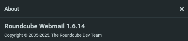

Thanks for the update @sahsanu! It seems something is off in my install. Could you have a look? Thanks in advance.
root@host:~# cd /var/lib/roundcube/
root@host:/var/lib/roundcube# COMPOSER_ALLOW_SUPERUSER=1 composer -n update
Composer could not detect the root package (roundcube/roundcubemail) version, defaulting to '1.0.0'. See https://getcomposer.org/root-version
Loading composer repositories with package information
Updating dependencies
Your requirements could not be resolved to an installable set of packages.
  Problem 1
    - Root composer.json requires phpunit/phpunit ^4.8.36 || ^5.7.21 || ^6 || ^7, found phpunit/phpunit[4.8.36, 5.7.21, ..., 5.7.27, 6.0.0, ..., 6.5.14, 7.0.0, ..., 7.5.20] but these were not loaded, because they are affected by security advisories ("PKSA-z3gr-8qht-p93v"). Go to https://packagist.org/security-advisories/ to find advisory details. To ignore the advisories, add them to the audit "ignore" config. To turn the feature off entirely, you can set "block-insecure" to false in your "audit" config.

I did everything step by step, and still showing 1.6.14.
Show all the steps and the outputs.
service php8.3-fpm restart
Try running this command. It might help.
