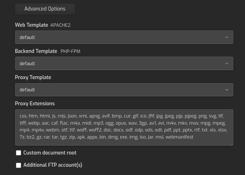

What I don’t see here is how to select one template or the other (default.tpl or ipv6.tpl once it’s copied and edited, of course). It would be a way to test this without affecting the site in any way.
Thanks in advance.
It’s correct but only for the web domain.
Edit your web domain, and in Advanced Options you can select the template from the dropdown list under Proxy Template.
