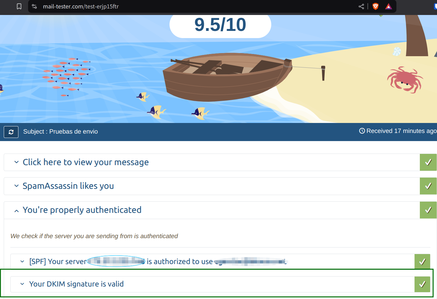

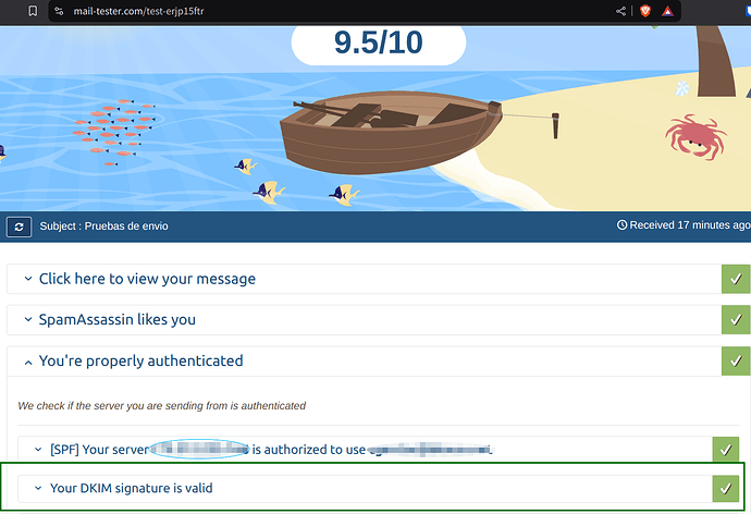

Hi @DevUX
If you want to check whether the DKIM key that Exim is using and the one you have in Cloudflare are the same, execute these commands from your Hestia server, both results should be the same:
Note: replace example.com with the actual domain name:
dig mail._domainkey.example.com txt +short | grep -Eo 'p=.*' | sed 's/^p=//' | tr -d '" ' | md5sum | cut -d ' ' -f1
openssl rsa -in /etc/exim4/domains/example.com/dkim.pem -pubout 2>/dev/null | grep -v -- '----' | sed -z 's/\n//g' | sed -z 's/$/\n/' | md5sum | cut -d ' ' -f1
Hi @sahsanu,
Thank you so much for your help :victory_hand:. It helped me confirm if the keys were correct. This confirmed that Exim was working correctly and that the Cloudflare key was correct.
I disabled and then re-enabled DKIM, ran the scripts, and confirmed that the keys were now the same. Finally, I ran one more test using the tool https://www.mail-tester.com/ and the score was 9.5/10, which confirms that it was resolved.
Thank you so much for your time and help.
