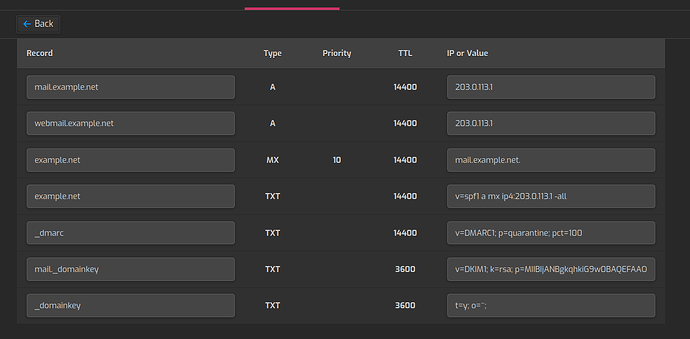

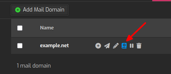

Regarding the DNS records you need to add in DigitalOcean for the mail domain: once you’ve added the mail domain in Hestia, click on the DNS Records icon.
And you will see all the records and values you need:
o cool Thanks so much
I just reference these details back to my DNS records?
