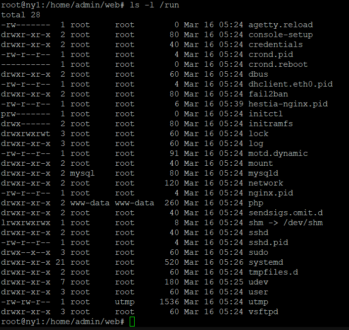

hello, what if i don’t have /run/hestia-php.sock ?
solved, got from this: [Bug] How to stop upgrading · Issue #4784 · hestiacp/hestiacp · GitHub
my step:
