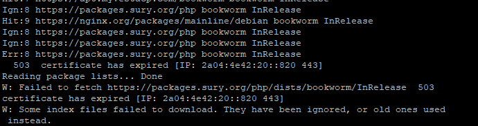

hey someone can help me with this ?
when i run apt-get update getting this
after visiting https://packages.sury.org/php/dists/bookworm/InRelease
There’s nothing you can do, just wait until they fix the certificate issue.
ok thanks.
You are, of course, correct. However it may be a minute. The initial report was closed already.
It seems that the certificate that the origin server presents to the Fastly CDN is what has expired, and that is how the CDN responds when it encounters an expired origin certificate.
Someone has opened a duplicate issue. Hopefully it won’t take too long for him to replace the expired origin certificates.
