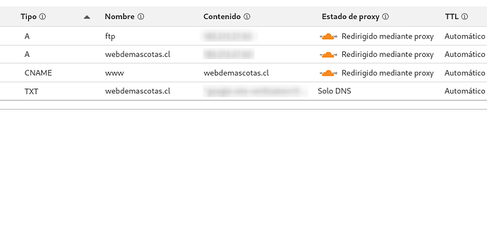

The error is independent of the domain, I’m sure of that.
The error is a 404 trying to validate the domain:
"2606:4700:3036::6815:1907: Invalid response from http://webdemascotas.cl/.well-known/acme-challenge/yFlh_pS4L3Vs4taEddC6Zk8Lf26t_mRqIcIXLeI5OIw: 404"
I’ve no idea how you configured Cloudflare’s Proxy but maybe you should use an origin certificate provided by Cloudflare instead of trying to issue a certificate from Let’s Encrypt.
On the same server I have 2 other domains correctly configured with their certificates issued from the control panel no problem.
Now, mentioning your recommendation, I would have used this alternative before but I couldn’t find the “SSL Certificate Authority / Intermediate” that I was missing, after reading the Hestia documentation I found (because in the control panel there is no mention of it) where to get the “SSL Certificate Authority / Intermediate”, I applied it and it worked. I applied it and it worked.
I don’t see anything in Cloudflare
