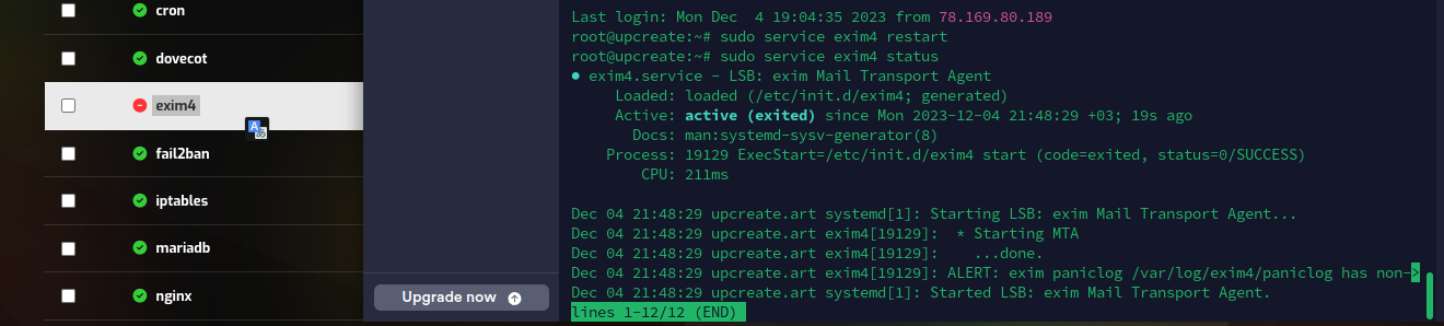

systemctl status exim4

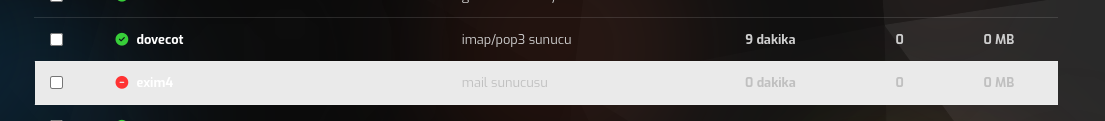

I guess hestia doesn’t see exim4
If I delete exim4 and reinstall it will it work or will it be worse?

What is the contents of /var/log/exim4/paniclog?
2023-12-04 21:48:16 exim 4.95 daemon started: pid=18694, -q30m, listening for SMTP on port 25 (IPv4) port 587 (IPv4) and for SMTPS on port 465 (IPv4)
2023-12-04 21:48:16 Cannot open main log file “/var/log/exim4/mainlog”: Permission denied: euid=116 egid=122
2023-12-04 21:48:29 exim 4.95 daemon started: pid=19378, -q30m, listening for SMTP on port 25 (IPv4) port 587 (IPv4) and for SMTPS on port 465 (IPv4)
2023-12-04 21:48:29 Cannot open main log file “/var/log/exim4/mainlog”: Permission denied: euid=116 egid=122
Error is clear …
touch /var/log/exim4/mainlog
and chown Debian-exim adm mainlog
Do the same for reject log
And then clear panic log again
I gave all the permissions, I think it’s working now
