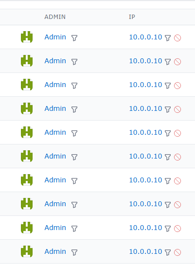

Hi, I have just installed FOSSBilling on an Oracle Cloud Free Tier instance running HestiaCP.
I noticed that FOSSBilling’s admin login/activity log is recording a private IP address instead of the client’s public/WAN IP address.
The server itself has a private OCI VCN IP with a public IP associated with it. I would like FOSSBilling to correctly record the actual client IP rather than the internal/private IP.
Currently using HestiaCP default tpl for the fossbilling installation, please help and advice.

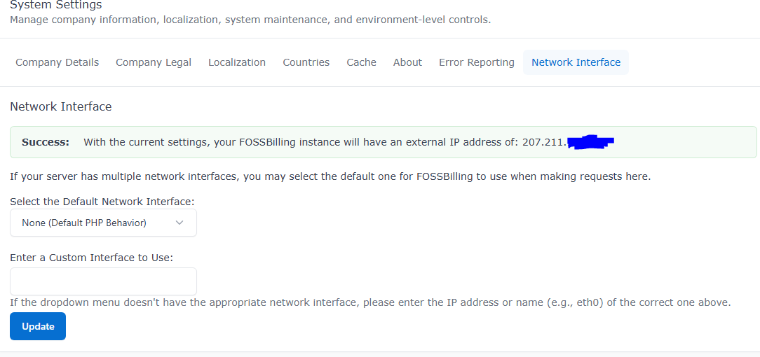

Edit: Added a screenshot for reference.

Not sure about the trusted proxy settings, but I believe I’ve seen them somewhere. I’m using Nginx + Apache as my web server, and I noticed a similar issue with WordPress, where all visitor comments show the commenter’s IP as a private subnet address (10.0.0.x).
Additional info: The Network Interface section in Settings shows the correct public IP, but in the logs and other sections, everything is being recorded as a private IP (10.0.0.x).
Thanks for the clarification! Since both FOSSBilling and WordPress are logging the 10.0.0.x IP, the issue is definitely on the web server side (Apache), not the applications.
In a HestiaCP Nginx + Apache setup behind Oracle Cloud’s NAT, Apache sees Nginx’s or the internal network’s IP instead of the visitor’s real IP.
