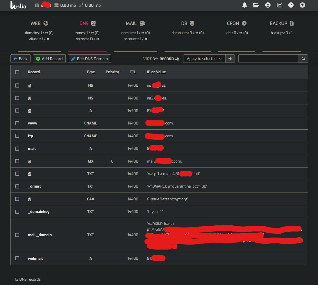

I suspect DNS records being messy here, I covered up for the attached picture my public IP, myselfhosting (.es), and mywebsite(.com). There’s a WireGuard VPN in place to connect to both Plesk and the server running HestiaCP, which seem to run just fine.

Hi @sysmin,
Reading your post seems like mywebsite.com is being used at the same time in your Plesk and Hestia servers. Could you please clarify if that is the case?
Yes, I’d like to migrate some WordPress websites from Plesk to my new HestiaCP server, which have some mail accounts too. The newer mail acounts should keep the same name and password, then imapsync logs in and transfers all messages. Or so I thought :sweat_smile:
But if your domain points to your Plesk server, if you try to login to the mail account created on Hestia it will try to login on Plesk server because the domain is pointing there.
Maybe I’m missing something…
That’s how it goes for Thunderbird, I know. Domain names are kept the same, but DNS config and IPs are about to be upgraded to a new server.
