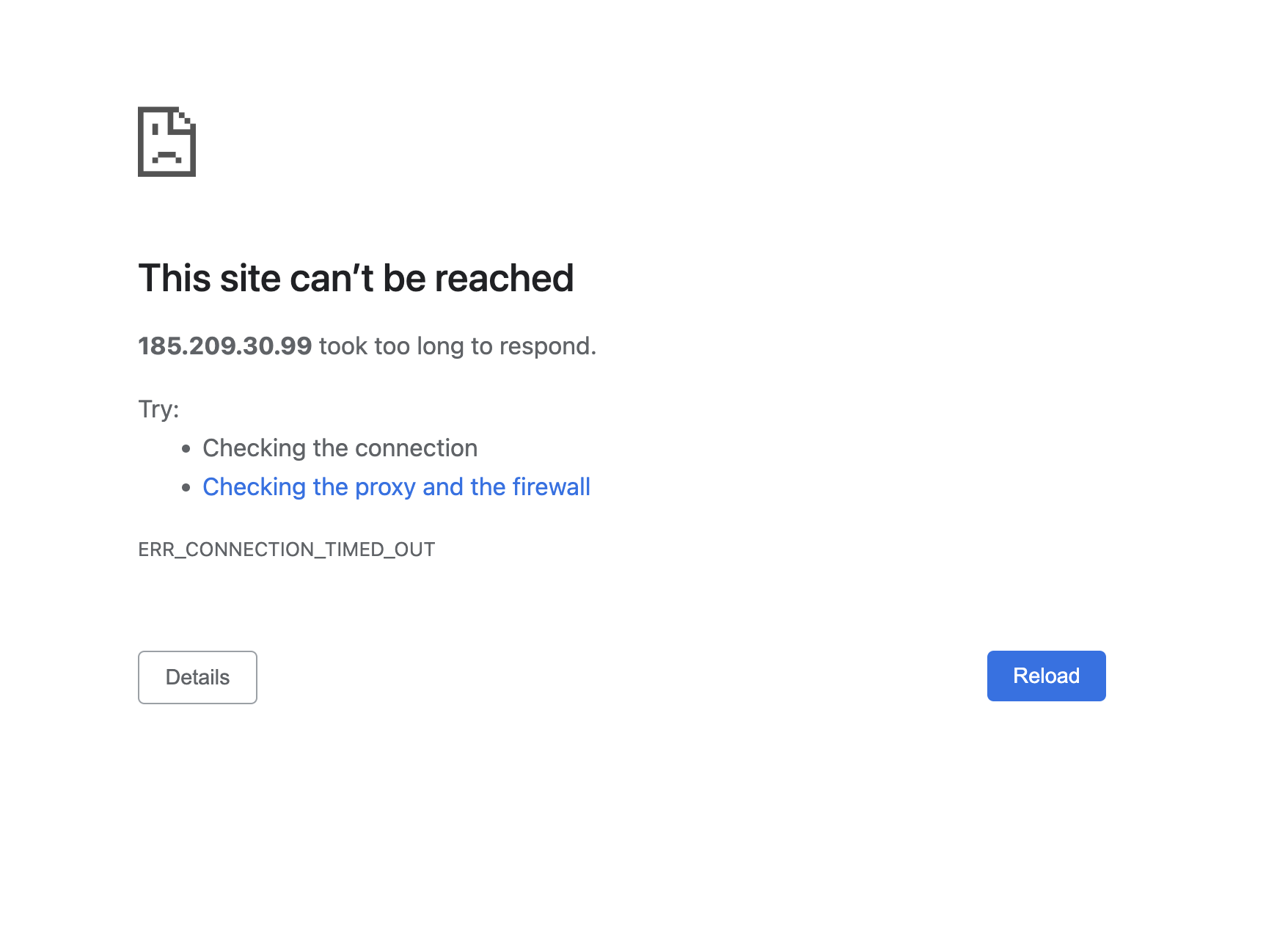

Somehow I accidentally changed some settings and now Hestia control panel which is in SERVER_IP:8083 redirects from http to https. As I know https works only for domain names. In my case the Hestia panel in is not in domain, it is in SERVER_IP:8083. So it tryies to open the site with HTTPS and it say :
This site can’t be reached
SERVER_IP took too long to respond.

I don’t think that it is because of firewall becuase I have tried different VPN and with different devices. Nothing has changed:
Why I am asking to change to http is becuase before it worked fine. And now I need to change something as soon as possible.
