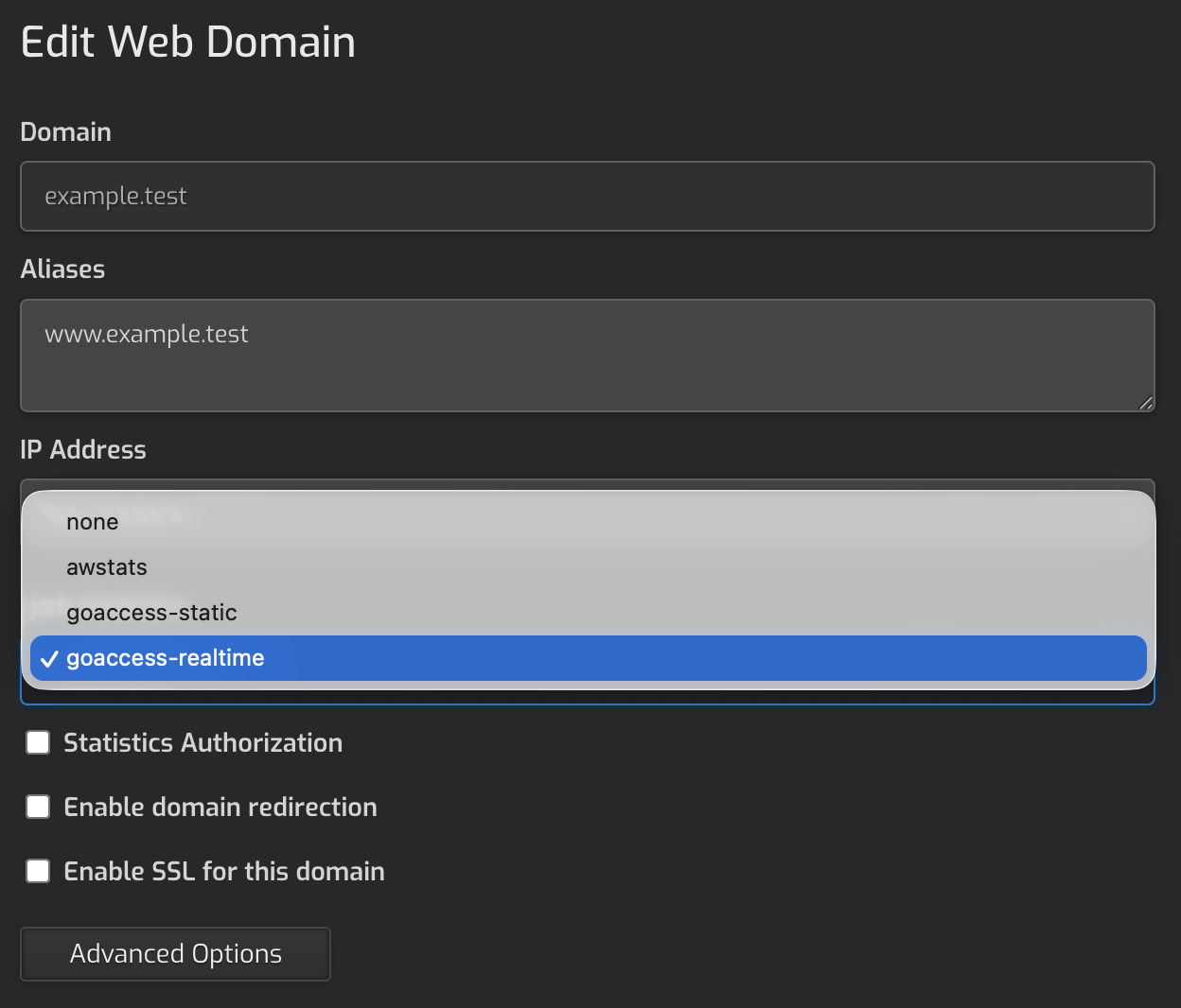

The goal was to provide a privacy-friendly alternative to AWStats using the server’s existing access logs. It adds two selectable Hestia web statistics options per domain:
  • goaccess-static
  • goaccess-realtime
Installing is as easy as:
cd /root
git clone https://github.com/Wutime/hestia-goaccess.git
cd hestia-goaccess
./install.sh
Administration per domain is easy, just choose realtime or static.

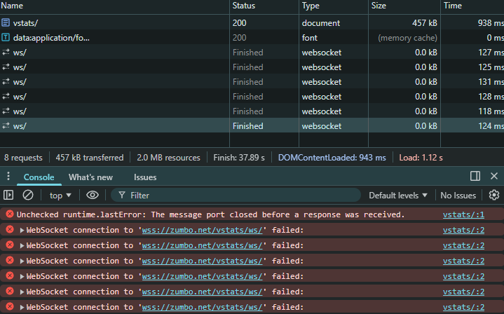

Unable to authenticate WebSocket. error on goaccess-realtime
Thanks for reporting this.
Could you share just these four things?
  1. What does this show?
    goaccess --version
  2. What does this show? (replace with your USER and DOMAIN for the USER)
    sudo hestia-goaccess status USER DOMAIN
  3. In browser dev tools, on the Network tab, what status code do you see for /vstats/ws/?
    Common examples are 101, 401, 403, 404, or 502.
  4. Are you using nginx or just apache?
Also: is the domain behind Cloudflare or another reverse proxy/load balancer?
The most common causes are:
  • the WebSocket URL points to the wrong hostname, for example example.com vs www.example.com
  • the public WebSocket URL is missing the explicit :443 or :80 port
  • the domain uses a custom Hestia/Nginx template that does not load the add-on’s Nginx include
  • a proxy such as Cloudflare/load balancer is not passing WebSocket upgrade traffic
  • an older GoAccess version has realtime WebSocket issues
If your site redirects to www, try re-enabling realtime with the exact hostname shown in the browser:
sudo hestia-goaccess enable USER DOMAIN --mode realtime --ws-url wss://www.example.com:443/vstats/ws/

GoAccess - 1.10.2.
realtime_port='64000' service='hestia-goaccess-zumbo-zumbo_net.service' ws_url='wss://zumbo.net:443/vstats/ws/'
  html_prefs='{"theme":"darkGray"}'
  log_format='COMBINED'
  db_path='/var/lib/hestia-goaccess/zumbo/zumbo.net' keep_last='90'
nginx>apache>phpfpm
NO CF or other Proxy
Tried
Thanks, that screenshot helps. The browser is reaching /vstats/ws/, but the WebSocket is closing immediately.
Can you please run and paste the output of these commands?
sudo hestia-goaccess enable zumbo zumbo.net --mode realtime --ws-url wss://zumbo.net:443/vstats/ws/
sudo hestia-goaccess status zumbo zumbo.net
sudo grep -o "wss://[^\"']*" /home/zumbo/web/zumbo.net/stats/index.html | head
sudo systemctl status hestia-goaccess-zumbo-zumbo_net.service --no-pager -l
sudo journalctl -u hestia-goaccess-zumbo-zumbo_net.service -n 80 --no-pager
sudo ss -ltnp | grep ':64000'
sudo nginx -T 2>/dev/null | grep -A20 -B5 'vstats/ws'
The Chrome extension message can be ignored. The important part is the failed WebSocket connection.
I want to confirm three things:
  1. the generated HTML really contains the expected WebSocket URL
  2. the GoAccess realtime service is actually running
  3. nginx loaded the /vstats/ws/ proxy location and points it to 127.0.0.1:64000

Didn’t work. i tried both 1.0.4 and 1.0.5
Maybe problem is on my server. Never mind.

Thank you for testing. Please do not worry, your server is not necessarily the problem.
From your output, the realtime service is running and GoAccess is listening correctly. So this part looks OK:
Active: active (running)
goaccess ... --real-time-html ... --ws-url=wss://zumbo.net:443/vstats/ws/
The remaining problem is probably one of these:
  1. Nginx is not loading the /vstats/ws/ proxy include
  2. The browser is using stale cached /vstats/ HTML after the realtime service restarted
  3. The public domain/redirect does not match the WebSocket URL
  4. A proxy such as Cloudflare is interfering with the WebSocket request
Version v1.0.5 has a better doctor check for this exact issue. Please run:
hestia-goaccess --version
sudo hestia-goaccess doctor zumbo zumbo.net
Please send the full output.
Also please try a cache-busted dashboard URL once:
https://zumbo.net/vstats/?fresh=1
If your site redirects to www.zumbo.net, please regenerate realtime with the www host:
sudo hestia-goaccess enable zumbo zumbo.net --mode realtime --ws-url wss://www.zumbo.net:443/vstats/ws/
Then test:
https://www.zumbo.net/vstats/?fresh=1
If your site does not redirect to www, keep the non-www host:
Then test:
The browser URL and the WebSocket URL must use the same public host.
If goaccess-static works, you can safely use static mode while we debug realtime:
sudo hestia-goaccess enable zumbo zumbo.net --mode static
Static mode does not use WebSocket.
