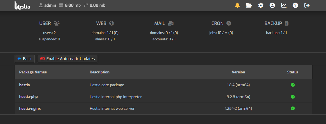

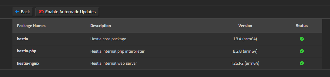

Currently running 1.8.4 with auto updates disabled, and I noticed that 1.8.5 was released 2 days ago.
My system doesn’t seem to realize it isn’t up to date. I remember this used to work a few versions back, so perhaps a recent change affected the update checks?

The reason you can’t see there is an update is because a typo in script /usr/local/hestia/bin/v-list-sys-hestia-updates
Line 105 is:
if [ -n "$hesta_v" ] && [ "$hestia_v" \> "$VERSION" ]; then
And $hesta_v should be $hestia_v, like this:
if [ -n "$hestia_v" ] && [ "$hestia_v" \> "$VERSION" ]; then
