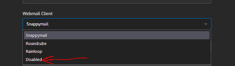

As discussed in my review of the code of @nagr - your issue doesn’t have to do anything with that. The Issue stems from you enabling webmail on the webdomain:
If you disable the webmail, this code won’t run, not changing anything on your DNS entries.
