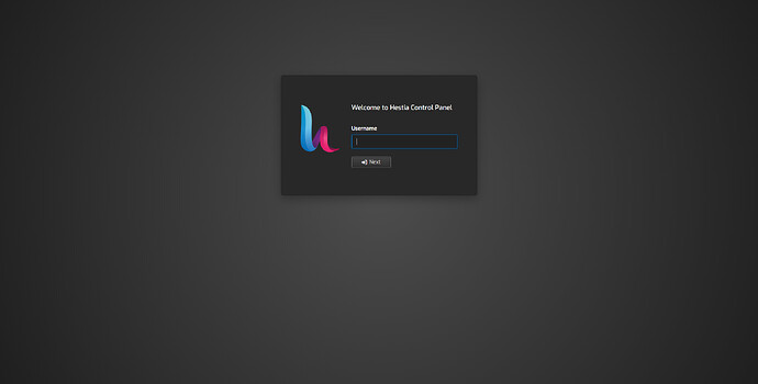

and now Hestia went from this

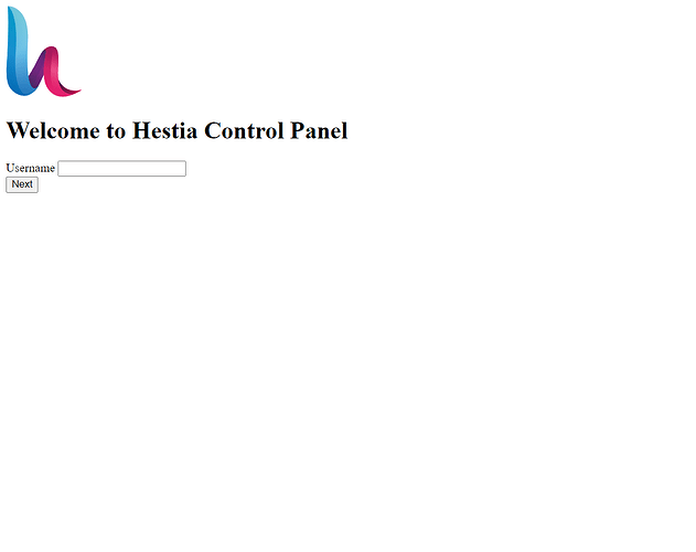

to this (and even clicking I can’t even go to server settings)

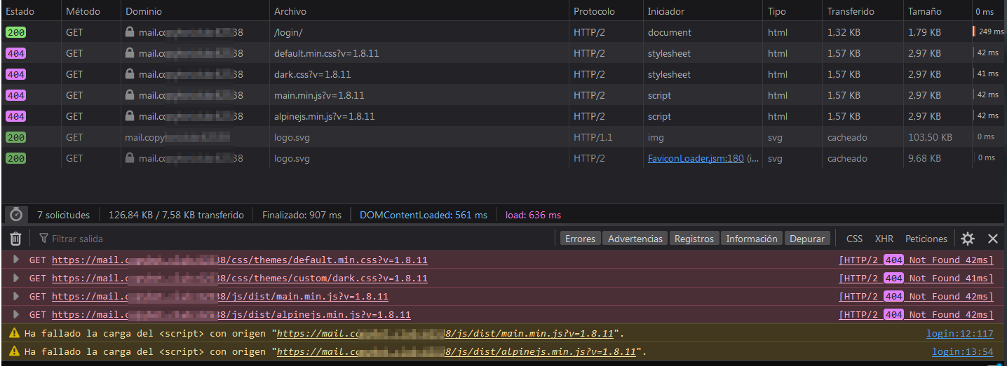

I just want to say that seems your nginx doesn’t have the right conf or it can’t found several js and css files:

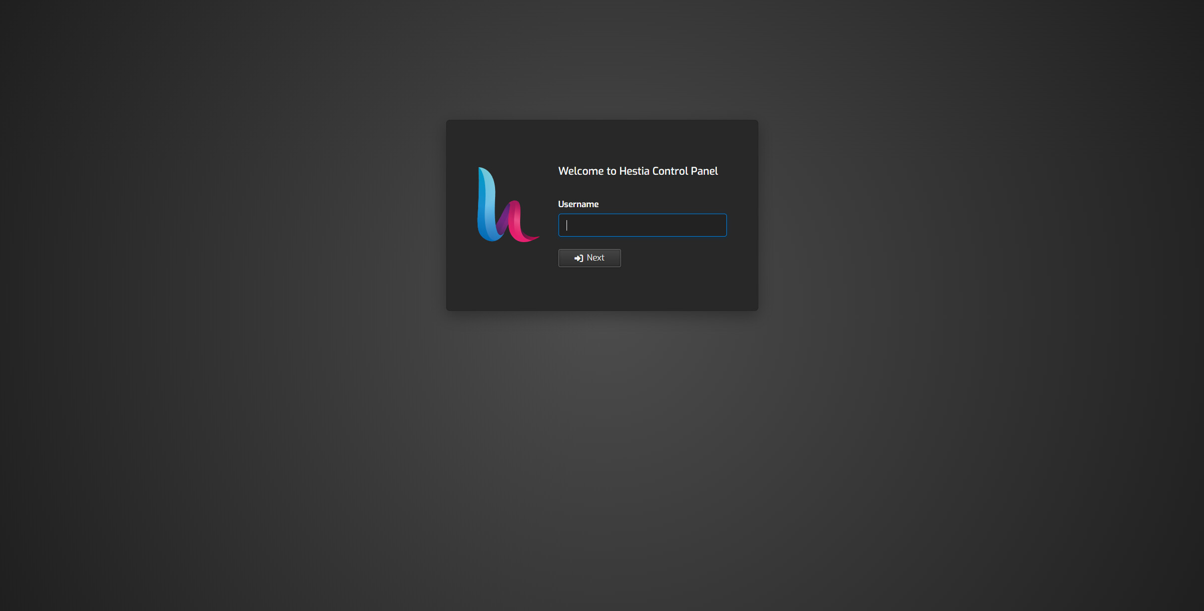

apt install hestia --reinstall
Did solve the issue …
