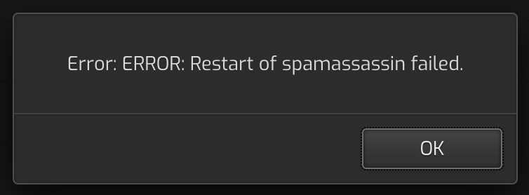

(As a side note, it looks like restarting spamassassin from the web panel fails and just says “Error: ERROR: Restart of spamassassin failed.”; I’ve been using service spamd restart)

root@luna:~# spamassassin --lint
root@luna:~#
It seems to be fine, but the web version complains:
This appears to mention it (it works!), but it does seem related to my upgrade of Ubuntu 22 to 24. Maybe it should be mentioned on the system upgrade page?

Indeed it looks like a bug, I’ll take a look later, for now:
v-change-sys-config-value ANTISPAM_SYSTEM spamd
Yes, those scores supersedes the ones in /usr/share/spamassassin/ but did you only copied sh_scores.cf? You should also modify sh.cf with your DQS Key and copy it also to /etc/spamassassin/

I went the old-school way and edited the .conf file directly. :smiley: (I also updated my post a few times to avoid adding more, so it may have changed while you were replying; sorry!)
Yes, I copied both and it seems to work for now; I’ll test in the coming days, before moving my main domain to this server so I can finally shut down my DreamHost account. I’ve been holding off precisely because I’m terrified of losing email.
Yep, that’s what I figured out and tweaked by hand (again, sorry for probably editing my message while you were already answering!)
